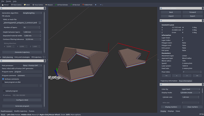

ROS Additive Manufacturing (RAM) provides a set of tools (mostly algorithms and GUIs) to help end users create complex trajectories for additive manufacturing. The project is especially focused on printing metallic parts with industrial robots. This project contains multiple tools: path planning algorithm able to generate complex trajectories, visualisation tools, editing tools, etc.
The application contains an algorithm that we found in a thesis, it allows to generate continuous trajectories from the start of the process to the end of the part (the whole part is built in one shot), this is very interesting for many aspects (material health, no dead-times) but also has some drawbacks (heat management). We developed a set of ROS messages, services, actions, nodes and GUIs that enables this whole application to work.
Here are screenshots of the application as of today:
The user can modify each pose of the trajectory: robot speed, feed rate, robot pose, laser power, feed rate etc…

Plastic FDM? If so I would recommend using already existing slicers to generate the trajectory, such as Slic3r. The problem is that they are not compatible with robots. Integrating Slic3r into ROS AM is in our plans but nothing has been done yet; Integrate Slic3r to generate trajectories (#144) · Issues · InstitutMaupertuis / ros_additive_manufacturing · GitLab
You could also convert the GCode output of Slic3r into a robot program directly but then you don’t get the editing abilities of ROS AM and the possibility to simulate the trajectory in ROS (you could simulate the trajectory with the robot manufacturer off-line programming software).
The robot parameters etc goes into an other package, for example if you are using a Fanuc robot you would probably want to use the ROS-I fanuc or fanuc_experimental packages.

ROS Additive Manufacturing generates a trajectory that is a ROS message (defined here: ram_msgs/msg · melodic · InstitutMaupertuis / ros_additive_manufacturing · GitLab)
If you want to move a robot there are two options:
  • Generate a robot program, upload it on the robot and run it.
  • Use a ROS driver, connect to the robot and use MoveIt to move the robot.
For the first option you need to write a post-processor, that will convert the ROS Additive Manufacturing trajectory into a Kuka (in your case) program that contains the right instructions for your process.
This process is explained here: ram_post_processor/README.md · melodic · InstitutMaupertuis / ros_additive_manufacturing · GitLab
For the second option you need to read the ROS Additive Manufacturing trajectory and feed it to MoveIt (we are not using this approach as of today).
There are post-processors for the Kuka robots inside the GitHub - ros-industrial-attic/robodk_postprocessors: Open-source vendor-specific post-processors/code generators from RoboDK (http://robodk.com) repository, I have started a repository that allows to use these post-processors as ROS services: InstitutMaupertuis / ros_robodk_post_processors · GitLab (I’m focusing on Motoman now but merge requests for Kuka are more than welcome!)

The trajectory is published on a topic.
Every module publishes a new trajectory after it’s done working with the trajectory.
So for example if you modify the trajectory, the output of this operation will be the full trajectory (ram_msgs::AdditiveManufacturingTrajectory type) being published on the ram/trajectory topic.
All you need to do is create a subscriber that listens to the trajectory topic. Each time a new trajectory is generated, modified etc.. you’ll get a new message containing the latest trajectory.
