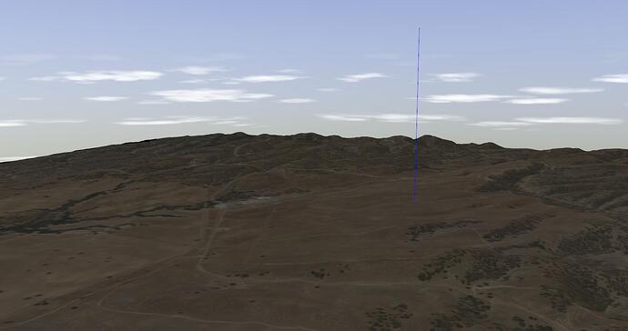

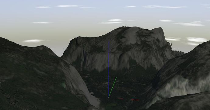

We’ve created several worlds from government data and are in the Gazebo model database, such as:
- mcmillan_airfield
- ksql_airport (with rough buildings)
- yosemite
- baylands (with additional trees and buildings).
Instructions for how we created these are noted in this readme:
