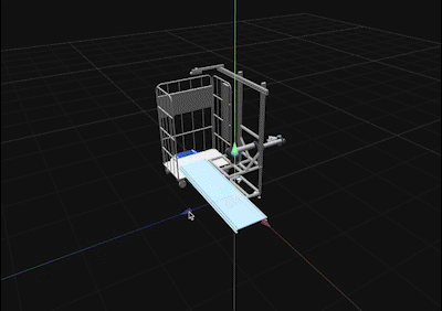

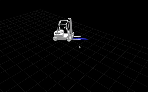

We extensively use them to build powerful browser-based user interfaces to develop and operate our robotics solutions built around rapyuta.io. Here are some examples for inspiration.
