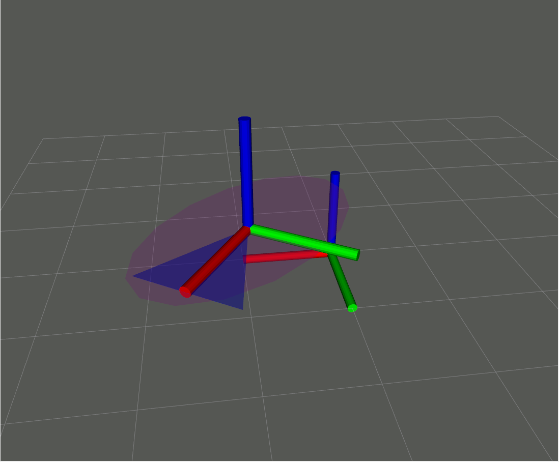

I decided to take a closer look at ign_rviz. I am trying to add the PoseWithCovariance display in this branch. However, I am encountering some strange behaviour.
I am currently adding a simple covariance visual, with no scalings and offsets yet so I do not need ROS messages to test rendering. The display for now just calls the constructor shown here:

I am expecting to see one sphere, 3 cylinders and a cone when adding my display. However I see nothing. What’s perhaps weirder is that when I first add another display that draws something on the screen (e.g. AxesDisplay) before PoseWithCovariance display, something does seem to work. I do see the cylinders and the cone, and I can interact with them using their settings, but never the sphere. Even if I just change the geometries passed to orientation_visuals_ from Cylinder/Cone to Sphere, I can’t get any spheres to be drawn.
