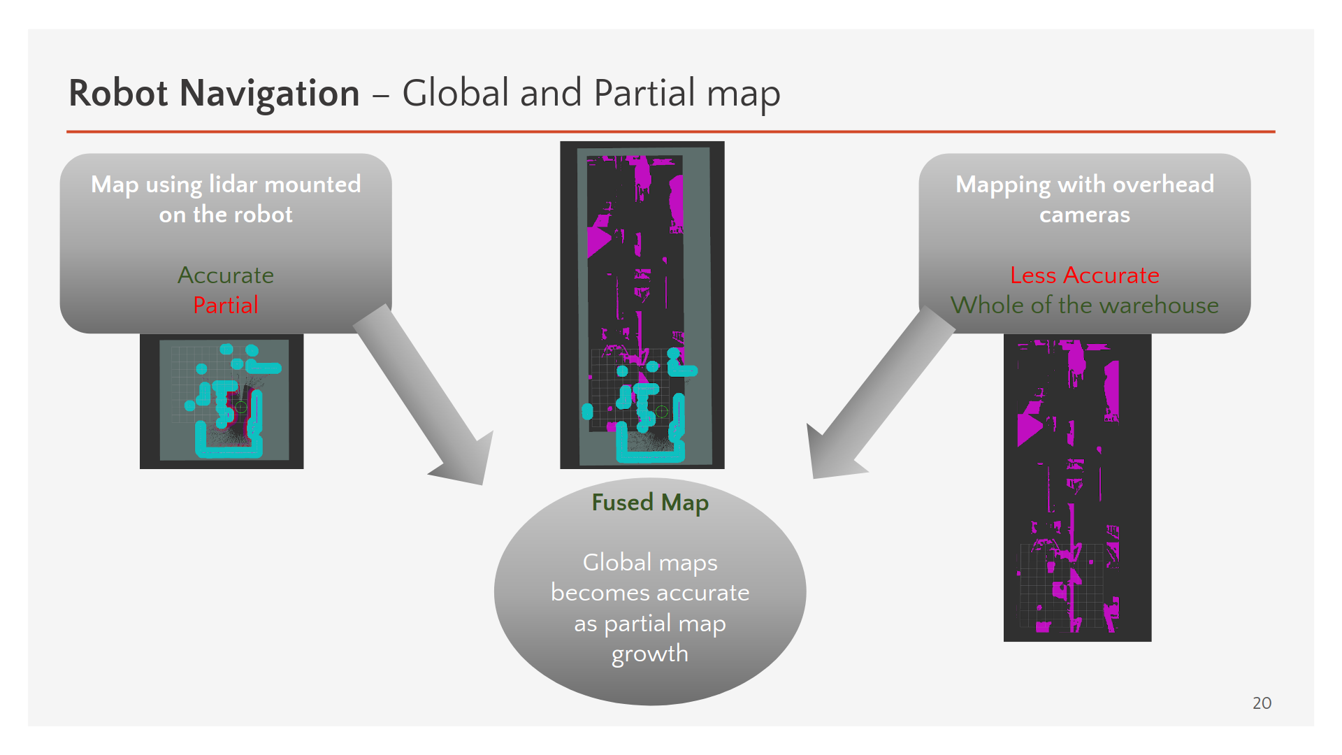

We are working on developing a mobile robot that has to carry packages around in a warehouse. The thing really matters in this project, is that robot should avoid explorations as much as possible. Due to the limited field of view of the on-board sensors, we have to put a few overhead cameras on the warehouse ceiling, looking downward. These overhead cameras are being used to segment the floor to the occupied/free pixels, leading to an occupancy grid map (we call it an overhead grid map). So we have an overhead grid map and a grid map which is obtained from onboard sensors (the onboard grid map is a subset of the overhead grid map, and the grids in overlap will fuse together).

As you may have noticed, the packages are decoupled from Nav Stack. We are interested to develop these packages somehow to can be used as a plugin to Nav Stack. Our main concern is about developing the overhead grid map. My first thinking was developing the overhead grid map as a costmap 2d plugin.
Develop a costmap 2d plugin that receives the segmented images, and the output is a costmap layer. However, to the best of my knowledge, it may violate the costmap 2d plugins’ rules. For example, the overhead plugin has to resize the layered_costmap_, which seems just static_layer is allowed to do.
Another one is developing a package that subscribes to the SLAM toolbox and expands its grid map by importing an overhead grid map.
What is the best way to merge this package to Nav Stack?

The following is a short update of what I did on this project until now:
  1. Generating synthetics dataset for ceiling image segmentation in Unity (Cite to Patric)
  2. Developing a ceiling_segmentation ROS2 package using TF 2.4 -Including Unit and DenseNet- that segments the images to the Free VS Occluded pixels - (Link to GitHub repo soon)
  3. Developing a ceiling_perception ROS2 package that accepts the segmented images and generates an occupancy grid map - alpha version
  4. Developing a ceiling_perception_plugin ROS2 package as a plugin to the costmap layer - alpha version
    ezgif.com-gif-maker
TODO:
  • For now, we assumed ceiling_camera poses and robot pose are known. In the next version, we will develop a method for localizing the robot w.r.t ceiling_cameras (unknown robot pose)
  • Although an accurate global map is not needed we may develop an elevation map (2.5 D) using RGB-D ceiling cameras instead of current 2D map
Any thought and suggestion will be appreciated.
