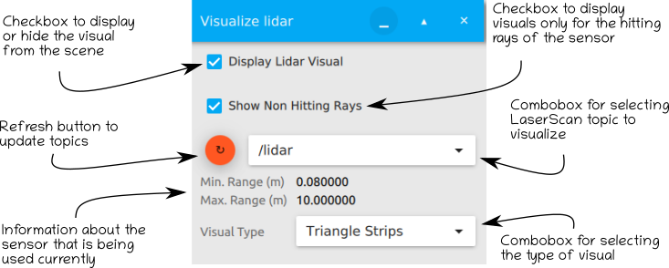

The developed visual was integrated with ign-gazebo as a loadable GUI plugin. The user can select the sensor message to display from and set the visual properties through the GUI. The following image shows a brief guide on the plugin:-

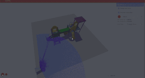

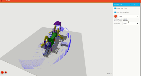

The visual type can be changed between Triangle Strips, Rays, and Points, as demonstrated below. This application helps to visualize the points as seen by the sensor in the simulation.
The following GIF demonstrates the change of topics for visualizing the data. Once the topic is changed, the frame of the visual is also changed, and the origin of the visual is set similar to the sensor origin.
The behavior of the lidar visual is shown below when it is mounted on a mobile base. The deselection of the “Show Non Hitting Rays” checkbox removes the visual of the data from the lidar that does not detect any obstacle. As a result, it makes it easier for the user to see the obstacles being detected by the sensor in its field of view without the additional clutter.
