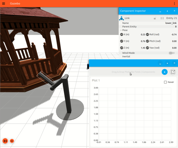

Physics Data Plotting
- Ign-gazebo plugin that has access to simulation physics data
- Users drag a specific component element via EntityTree & ComponentInspector Plugin and drop it into the plotting tool

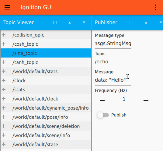

Topic Viewer Plugin
- Topic Viewer Plugin is an ign-gui plugin that lists all currently published topics and model each topic’s structure, so user can access its fields and nested fields.
- Plot-able fields are drag-able to be used in the Plotting tool
- Update topics dynamically in real time

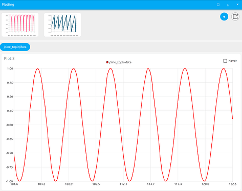

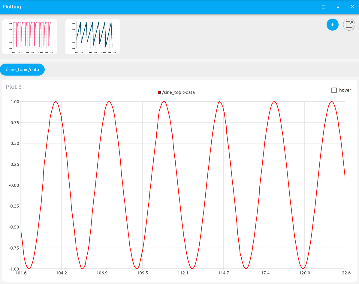

Transport Plotting & UI
- Transport Plotting Plugin is an ign-gui plugin that usess ignition transport library to handle transport plotting

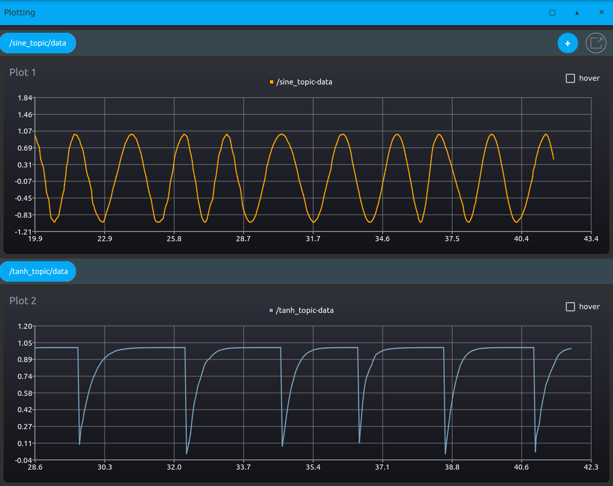

- Users drag the field of topic that they want to plot from the Topic Viewer plugin and drop it into the plotting tool to be plotted
- Users can have Many charts and many plotting elemnts (fields or components) for each chart
- Users can remove plotting elements at run time
- Users can scroll over the plot view & zoom

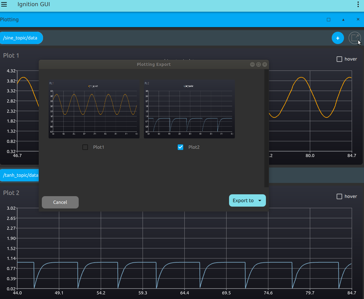

- Users can export each graph into a CSV Format
CSV Export
