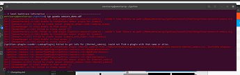

, but i got some issues, i followed the PRs, and it is working but not for all sensors (camera & thermal camera are not working), when i run the âsensors_demo.sdfâ, all sensors work except these 2, giving me that error.

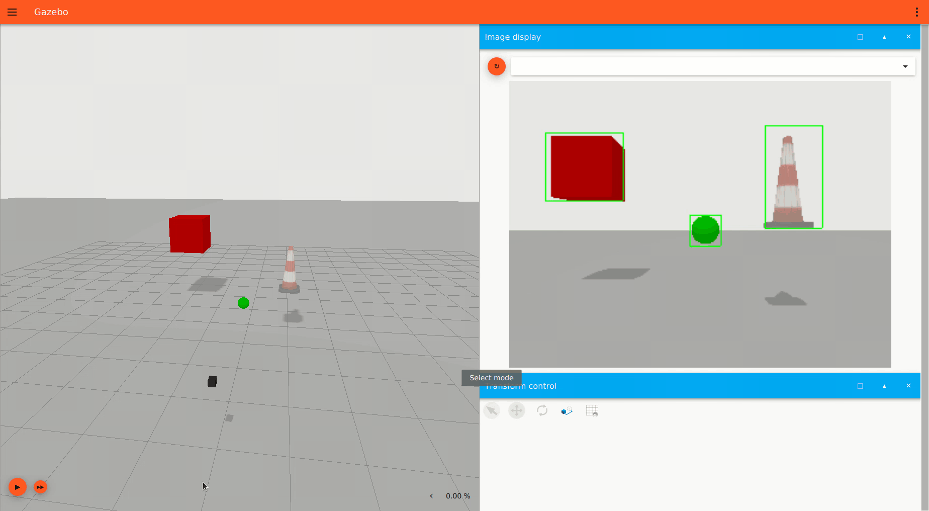

I tried to have a small prototype to the bounding box sensor, i composite the code temporary in CameraSensor class, till i am able to create it as one of ign-sensors
The idea i used is to get the 3D boxes of the visuals from the scene graph and convert it to 2D bounding boxes and used the camera parameters(from rendering::Camera) to check if that 3D boxes inside the camera frustum and get the projected points of the vertices to convert them to a bounding box.
Not sure if that is the best approach to do that, as i didnât use OGRE to get them, all the logic is by the Scene, what do you think about that ?

Yeah there are still known issues, thatâs why we didnât merge it into Edifice. We may be able to fix it by Fortress

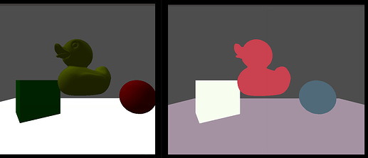

, iâve made a small version of the labels camera
I spent the last period in learning OGRE, reading ign-rendering code and following the rest of the tutorials.
I used a similar approach to the one in Ogre2SelectionBuffer:
- making a basic compositor workspace to render the scene to a render texture
- switching the material through MaterialSwitcher Listener at the Pre Render then getting the original materials back at Post Render.
- I made a class that inherits from MaterialSwitcher but changes the coloring in it by applying random colors (but each pass i reset the pseudo num generator with the same seed, so it generate the same sequence of random numbers each frame)
Here is the code Github
also i added an example of that camera Github
so that approach helps in instance segmentation data, for semantic segmentation, we can have another derived class from MaterialSwitcher that colors the objects based on its type (and this type may be selected by the user (may be in the UserDara such as Thermal Camera) )
