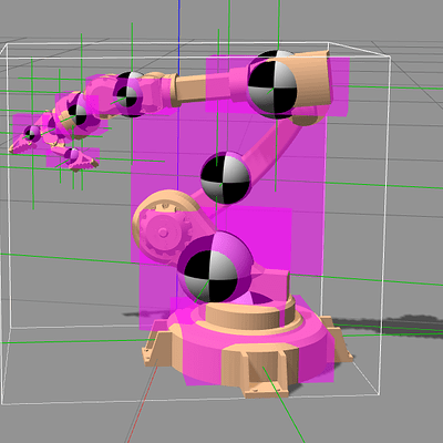

I wrote a fusion 360 add-in to export URDF from Fusion 360 models.
See:
https://github.com/syuntoku14/fusion2urdf
For example, you can convert this cool robot arm(https://grabcad.com/library/industrial-robot-10) into urdf with just one command.
(upload://hqn8wGJBlaawLC6nvu2KpmyJ8yv.png)
I’m happy if you try this add-in and give me feedback.
