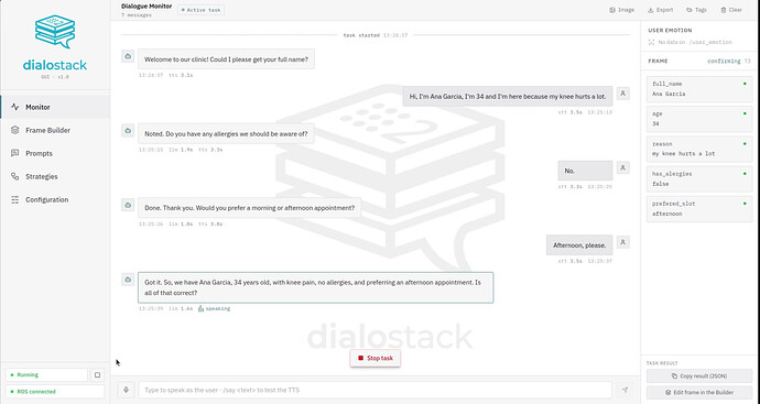

A slot-filling task in the web monitor: the frame on the right is filled turn by turn and confirmed before the action returns.

Everything goes through one action. You describe the task, and if you don’t pass a schema the engine generates one:
ros2 action send_goal --feedback /dialog/execute_task \
ros2_dialog_interfaces/action/DialogTask \
"{task_description: 'Take a coffee order: drink type, size and customer name',
dialog_mode: 'slot_filling', domain: 'coffee shop'}"
The robot asks for whatever is missing, handles corrections (“actually, make it a large”), confirms, and returns the filled frame as JSON in the result. You can also pass your own schema and a partially filled frame to resume an interrupted dialogue. There is a BehaviorTree.CPP leaf node that wraps the same action.
