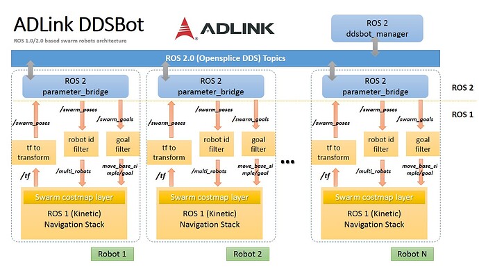

We are happy to announce the release of a ROS 2 based robots swarm projects held in ADLINK Technology/PrismTech.
The typical solution for swarm robots in ROS 1 is using either different namespaces or external communication (outside of ROS middleware). However, by means of ROS2/DDS capability, we can solve this issue more effectively. As shown in figure below, each robot in our architecture is fully-independent, self-awareness and fully autonomous(by navigation stack). Then each robot publishes its global position to ROS2 Topic Layer through ros1_bridge. Therefore, all the others will be aware of its position with the help of custom “swarm_costmap_layer”. The swarm network allows robots to join and leave dynamically without human involving or any beforehand configuration. Furthermore, the developer/user is able to monitor&control all robots through a ROS 2 node.
