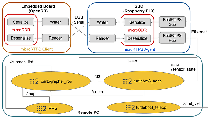

It’s great to see Turtlebot3 support for ROS2. Out of curiosity, why did you move to using a micro-rtps client for the LIDAR data instead of using roscpp directly? Additionally, it would be nice to see the source code for the new LIDAR node checked in directly instead of bundled in a tar file.
Hi @nburek
Of course, using roscpp to publish LIDAR data is more suitable. But we had some problem to publish it in Raspberry Pi 3 (microRTPSAgent problem with libfastrtps.so.1 in ROS2. · Issue #568 · ros2/ros2 · GitHub). We are going to debug what is problem.
And code for LIDAR node will be uploaded in github. Thank you for your suggestions :slight_smile:
