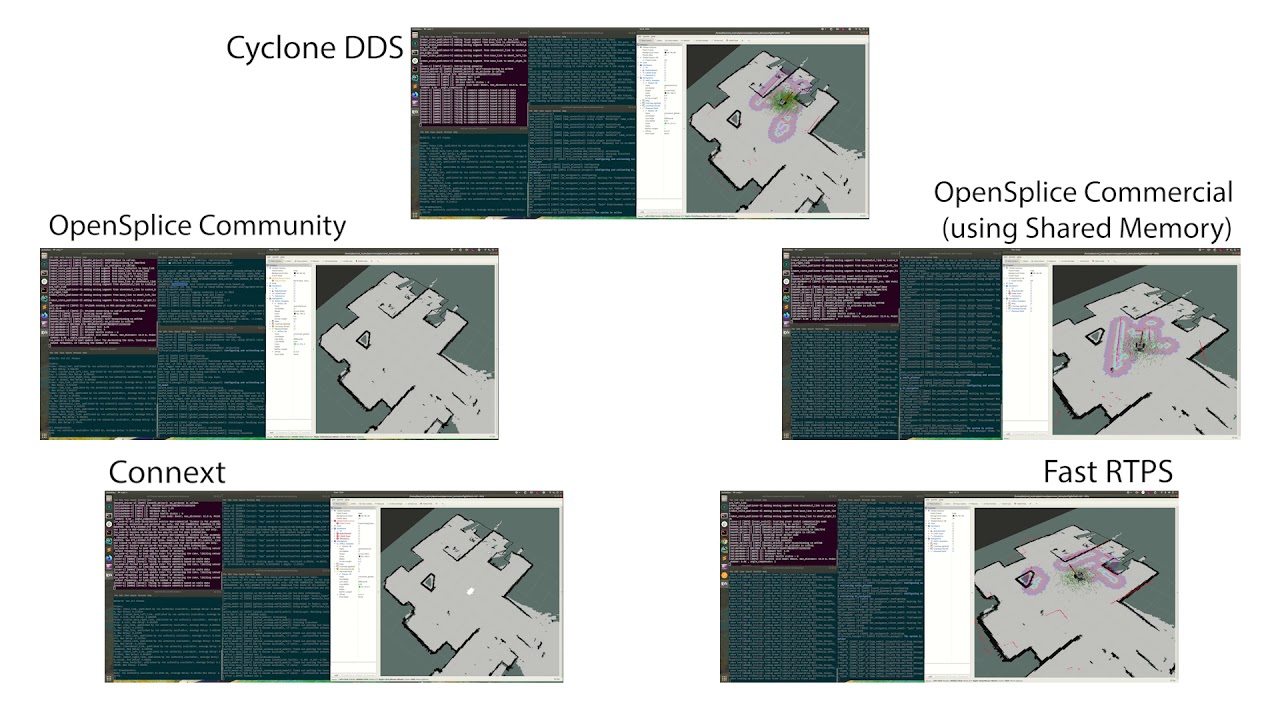

Hi @smac,
In Fast RTPS, you use multicast just for participant discovery (so “SPDP option” is not required, EDP is going to be always using unicast), and we have a very defensive defaults for this kind of networks. After Intel and others reported some problems over wifi on navigation, we reacted modifying the discovery behaviour, and changing the default parameters, some months ago, so that is already on place.
With those settings (now the default), our performance is really good. See this video from @rotu:
This is the case you are talking about, I think.
