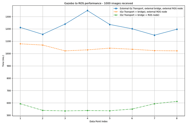

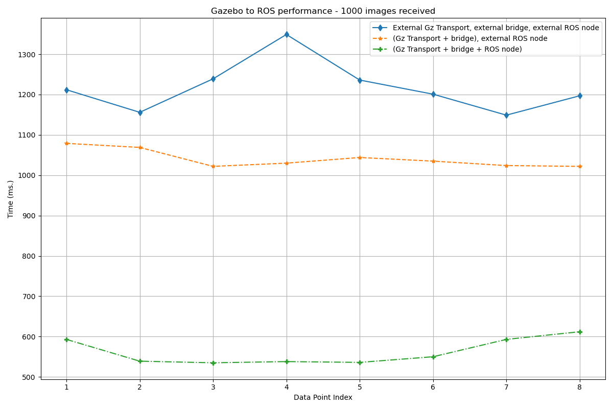

Here’s an example plot showing the time needed to receive 1000 images on the ROS side, published from Gazebo Transport. You can see how the time needed to receive the images drops when we combine more nodes within the same ROS container.
You can find the code and commands to generate this plot in this gist.
