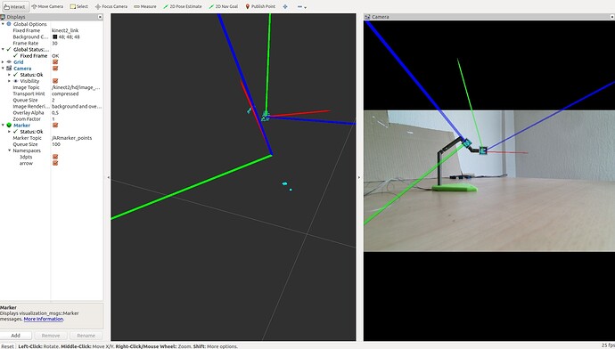

i installed ar_track_alvar, sticked two individualMarkers onto the distal and intermediate phalanx and here is the output
i stil got problems with detecting the markers with the kinect2, and if they are detected, they dither around. I need to re-calibrate the kinect2, then i hope it gets better, but for angle detection it looks good.

  • Markers will always flicker (at least with a kinect) no matter what you do, however the error you have is often negligible for most applications and acceptable given the relatively low cost sensor you are using. Plus I don’t think that recalibrating the kinect will improve the quality of markers detection, so I wouldn’t waste time on it.
  • You could build a mean average filter or a kalman filter to stabilize the flow of transformations from the markers, but still i found that the error committed is acceptable and building such a filter is often not worth it.
