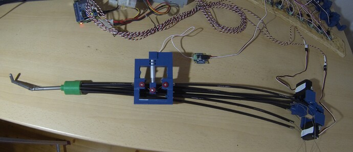

here is my first prototype of a force tester on wire rope. Its very big, but it works very well. The wire rope is pressing against a flexiforce sensor.
and the backside
perhaps someone got some good ideas ?
now its smaller, but still very big

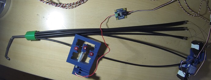

i made it smaller, it could get smaller, but it still produces good responses

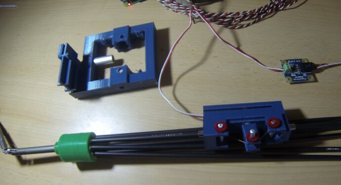

thats prototyping, i did a new one. Combined servo holder and force-tester into one small piece.
With this setup i reduced the selfmade things, like alu-pipe for winding and alu-connector to servo. The force tester still needs some metal/alu stuff, but this is not complex, time consuming. Now i need 8
Again, i made it smaller. Now its not getting much smaller with the flexi-force sensor. I made a picture which shows that only a minimum of selfmade stuff is needed for this combined servo holder with force/tension sensor, and it works pretty well.

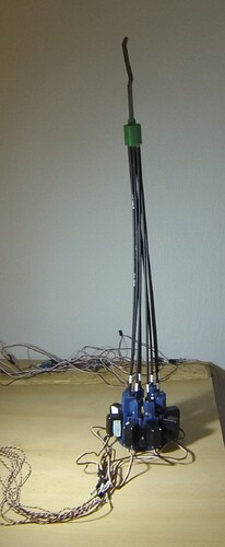

Wow, i like this setup. Its easy to handle (even if it perhaps doesnt look so) and works pretty good. And it is relativ small. I printed a ring, so i can easily plug every single combined-servo-holder into a hole of this ring.
Which then looks from bottom side, a little bit like the ATLAS experiment of the LHC (Large Hadron Collider) :slight_smile:
And fully assembled, ok without the wires to the flexi-force sensors, it looks so:
Where you can see, that it has a very small base
