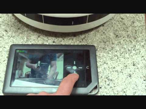

With a WiFi connected phone and some ingenuity, you would be able to issue voice commands. So you can call up your home robot from the office and ask it to find the cat. The Botvac is a little underpowered for bringing you a snack from the kitchen, but when the next more powerful platform is available, you’ll know just how to program it.

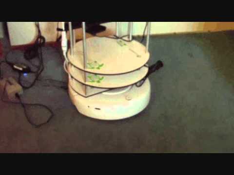

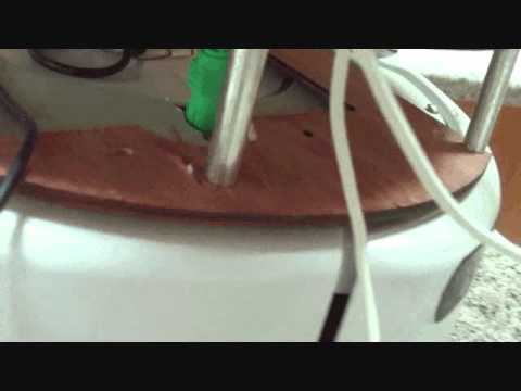

Youtubes of Turtlebot I from create base and voice control ~2013-2014? :
