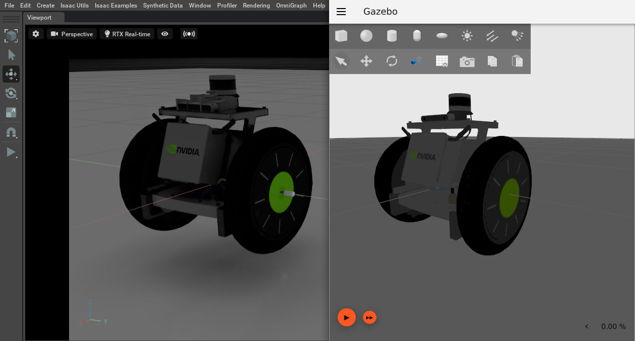

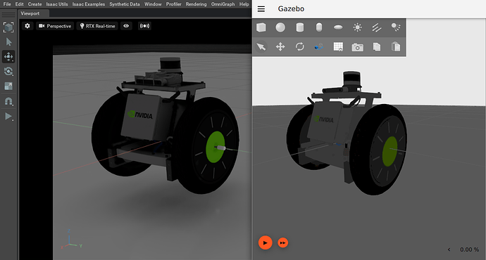

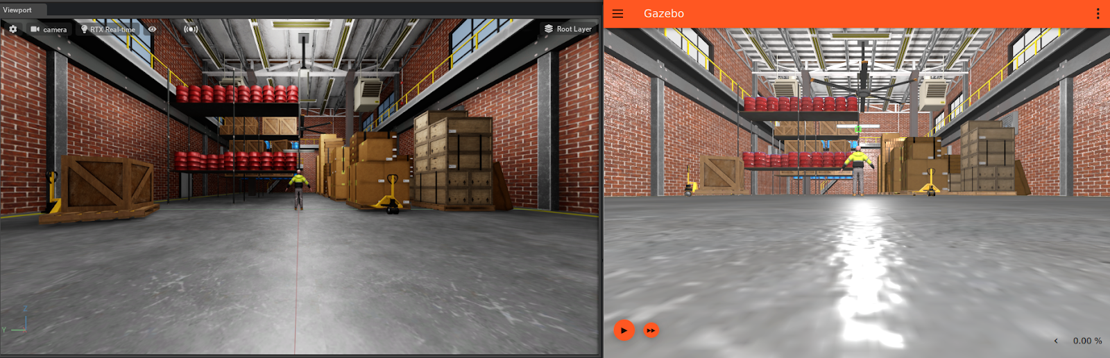

For the first item we developed a bidirectional SDF<->USD file converter. It takes as input an SDF file that works in Gazebo and produces as output a USD file that works in Isaac Sim with approximately equivalent results; and vice versa. This work is available through a component from sdformat12 [3]. If you want to check how to install it please check this instructions [4].
In the following images you can check some samples (left side Isaac Sim and right side Gazebo):
SDF ā USD
USD ā SDF

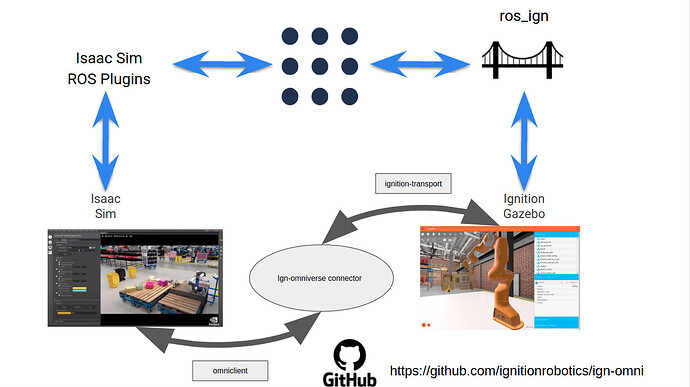

For the second item, we developed a bidirectional connector between Gazebo and Issac Sim. In the following image we can see the workflow between the two simulators.
It allows to:
- Transmit live modifications of a virtual environment between a running Ignition simulation and a running Isaac Sim simulation
- Incremental updates
- Support common operations, like model addition, deletion, and pose change
- Separate the simulation workload between Ignition and Isaac Sim, with both systems running in parallel. For example, physics can be handled by Ignition, with rendering handled by Isaac Sim, or vice versa.
This code is available in the gz-omni repository [5].
