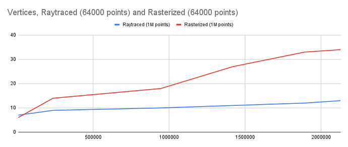

Performance Benchmarks
A key advantage of this approach is performance scaling. Unlike rasterization, which slows down significantly as scene complexity (vertex count) increases, the ray-traced method remains consistently fast. The performance gap widens dramatically in large environments.
These preliminary benchmarks on an RTX 3060 Mobile show that the ray-tracing pipeline maintains a much lower render time as the number of vertices in the scene grows into the millions.
