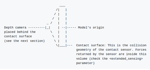

Tactile sensors are devices that measure information coming from the physical interaction with their environment, like your fingers or your skin do. Instead of focusing on one specific brand and model of the available tactile sensors in the market and simulating it, we switched our objectives and efforts into implementing a specific sensor technology such as an optical tactile sensor. These sensors are usually made up of a light source, a deformable surface, a lens and a camera. One of the aspects that make them very popular is that you can apply the already existing computer vision algorithms in order to extract information from that data.
As you can see in the previous screenshot from the tutorial, we used a contact sensor and a depth camera to simulate this behaviour. As objects come into contact with the former, surface normals are computed from the values returned by the latter. It is important to note that the values coming from the contact sensor are not currently used to make any computation, rather just for visualizing the contacts as a quick way to check that the plugin is working correctly. Due to lack of time, we could not merge the information coming from these two different sensors and provide a more realistic measurement.

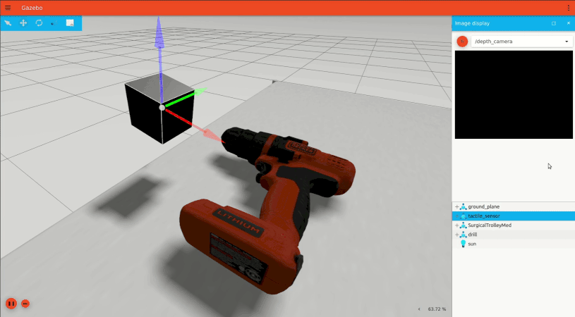

The following is an intermediate work showing how the plugin interacts with different Ignition Fuel models included in the simulation. Note how the plugin is able to visualize the surface normals of the objects it is being pointed at:
simulation
The plugin also provides rich information for objects where there is a considerable variation of the surface normals, like the drill below. It currently outputs the surface normals through a topic, which you could use to infer information like an optimal grasp, what part of the object you are touching or even to try and guess what the sensor is touching!
drill

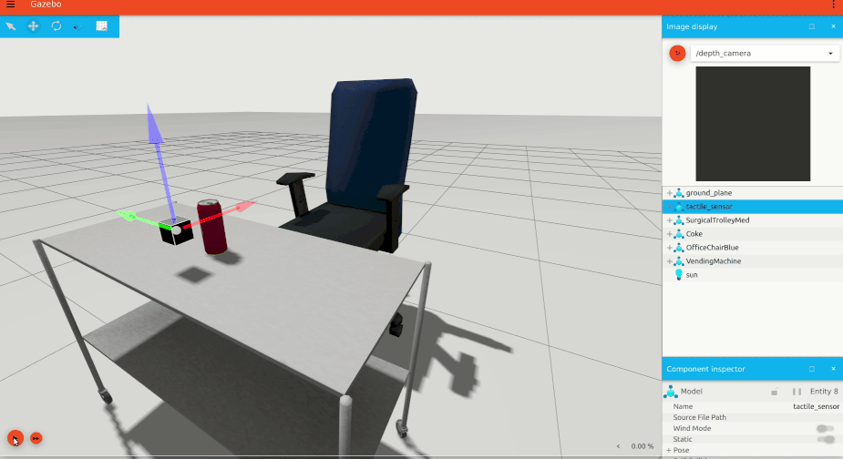

However, the final implementation only outputs the normals which are inside the contact surface, so you have to actually touch an object just like any tactile sensor would have to. Unlike the previous screenshots, in the following image the normals are visualized using simpler geometry in order to increase the performance due to lower message transport and marker rendering costs.
