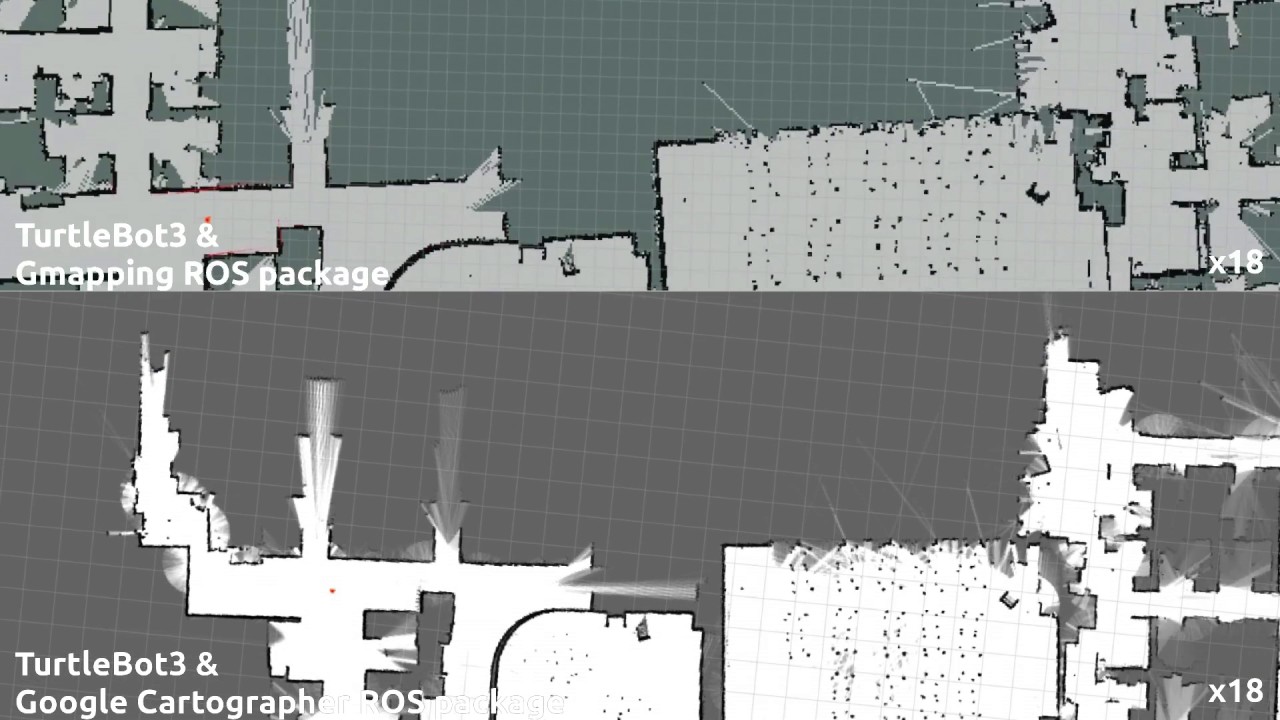

Have you seen IEEE Spectrum’s video Friday last? A video with Turtlebot3 was introduced. We will share the development news of Turtlebot3 every week. :wink:
Today, I would like to introduce the video related to SLAM which is the basic function of TurtleBot3.
Even if it is small size, low cost, we will do our best to SLAM and Navigation which is the basic function of Turtlebot brand.
Date: 2016.11.29
Robot: TurtleBot3 basic model
Sensor: Laser Distance Sensor
ROS package for SLAM: Gmapping / Cartographer
Place: ROBOTIS Labs & HQ, 15th-floor corridor
Duration: 55 minutes
Total travel distance: 351 meters

Could you share the associated bag for this video? I think the Cartographer results could be easily improved and we’d be happy to host a TB3 configuration with a demo bag.
You mentioned that you are using a “Laser Distance Sensor”, can you share which one you are using specifically?
It would be interesting to know how well mapping performs with a lower FOV sensor, like an Astra or Realsense.
Also is this running in real-time, if so which SBC are you using?

We share our bag data. https://goo.gl/7QAudM

The bag doesn’t seem to contain odometry. I assume you had that available for gmapping, though? Cartographer would also benefit from it.
@damonkohler
Thank you for your comments, I think that you can get the odometry information from /tf of above bag data.
Actually, we are currently using Gmapping as our main SLAM package. But we will soon change to the Cartographer package. You will need your help. :slight_smile:
Thanks, Pyo. Glad to hear it!
Odometry is usually provided via nav_msgs/Odometry messages. The /odom frame in /tf is then a product of some node that processes the odometry messages.
