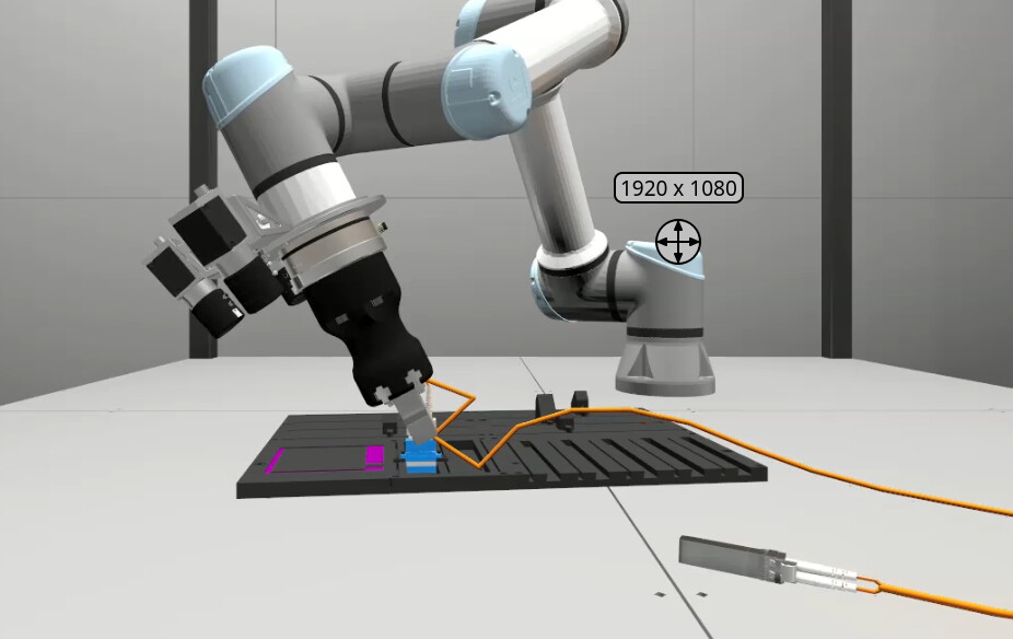

Regarding the force peaks , I am seeing them too. In video recording, I hit a 44N peak in Force Z . By using a custom visualizer to sync the dataset with the frames, I thinkg the culprit is The Cable.
  • left camera
  • right camera
  • center camera
  • Gazebo
As you can see in the global view at Frame 464 , the cable gets severely kinked into an “N” shape against the board. This creates massive mechanical tension that forces the connector out of alignment, causing it to hit the rim of the port. Even though the “CheatCode” policy is sending the correct coordinates, the physics of the cable is fighting back.
