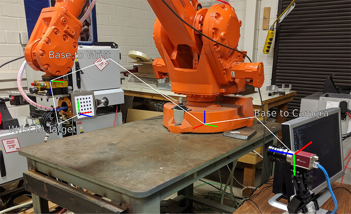

  • (Extrinsic) Camera on Wrist
  • (Extrinsic) Static Camera(s) Looking at Target on Wrist
  • PnP-esque target localization with one or more cameras
