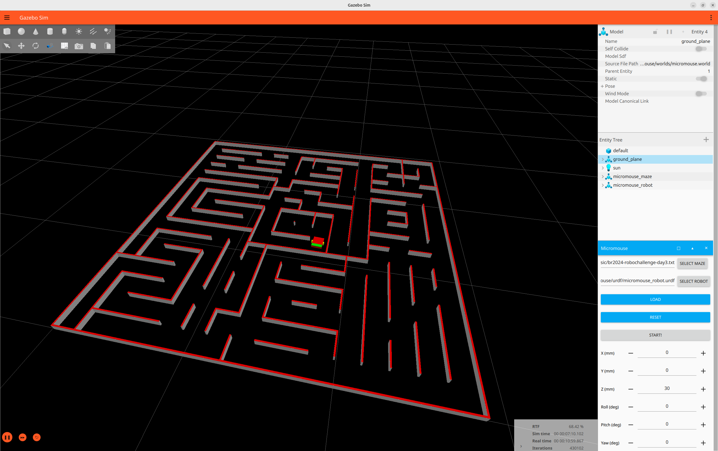

Ratada (GitHub - pedrofza/Ratada: Ratada is a 3D simulation environment for Micromouse robots based on Gazebo and ROS2.) is a collection of Gazebo plugins that make it easy to import mazes and robots into the simulation environment of a micromouse contest. It currently supports classic mazes (16x16).
Micromouse is a competition in which participants have to develop autonomous robots that solve mazes as fast as possible. Veritasium has good introductory video on it: https://www.youtube.com/watch?v=ZMQbHMgK2rw. You can find multiple recordings of past competitions on the internet. Contests often have similar rules, which I won’t cover here and are also not covered by the simulator. At this moment, it allows you to track the time it takes for the robot to go from the starting point to the goal of the maze.
One of the value propositions of the project is to enable users to set up and interact with a micromouse environment without needing a deep understanding of Gazebo internals. I’ve tackled this by providing a GUI that allows the user to import mazes from a human-readable text file format, and its robot from a URDF file. SDF robots are also supported. Some Gazebo knowledge is required for creating your own robot and defining its sensors and actuators. This could be improved by having a repository of micromouse robots! How awesome would that be?
