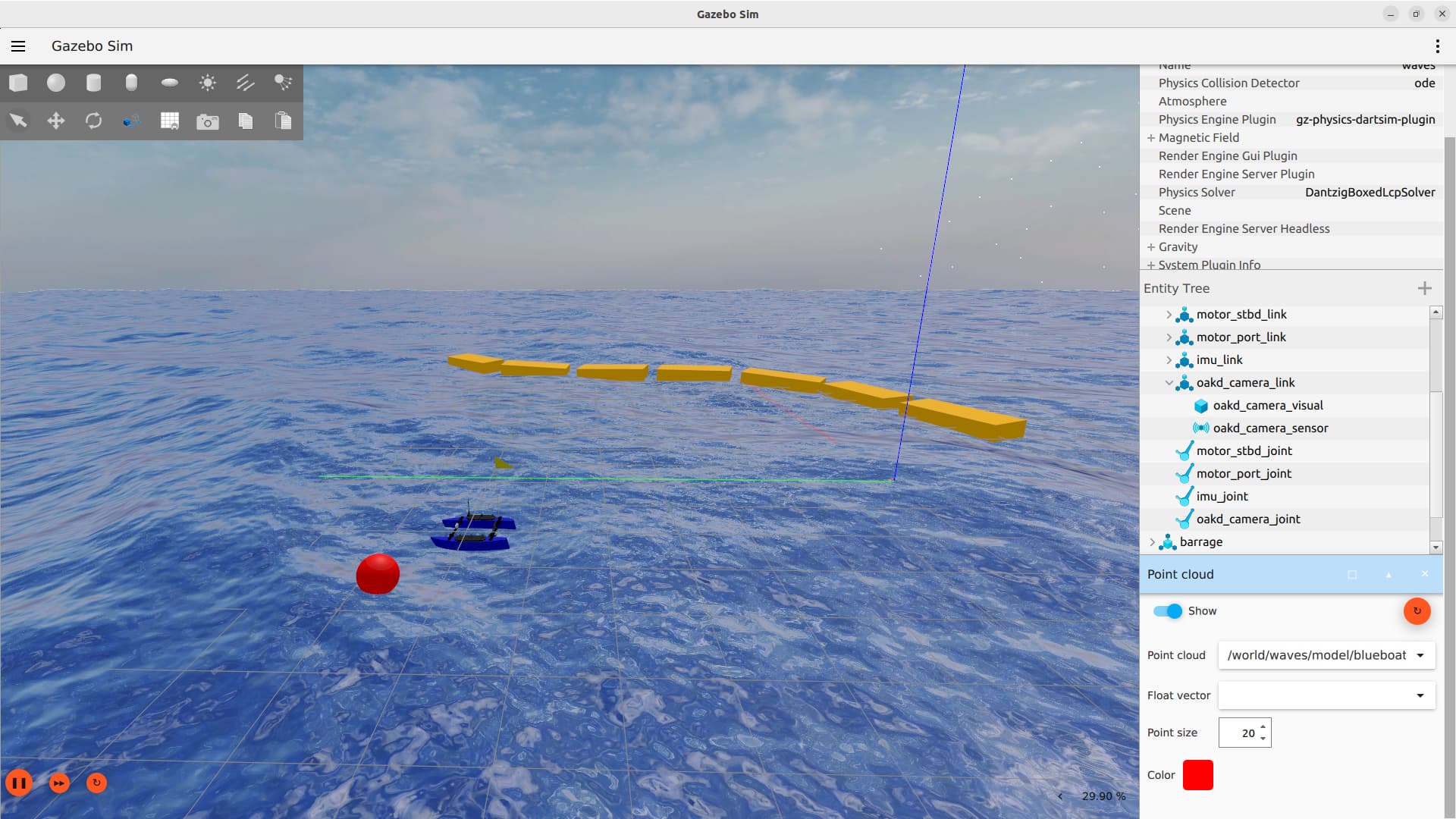

I’m currently developing a simulation environment with a BlueBoat model equipped with an OAK-D stereo camera and am using the ArduPilot plugin for control.
However, I’m encountering an issue where the point cloud from the OAK-D camera isn’t visualized in either Gazebo or RViz.
Key Observations:
- The point cloud topic is visible and being published in Gazebo (

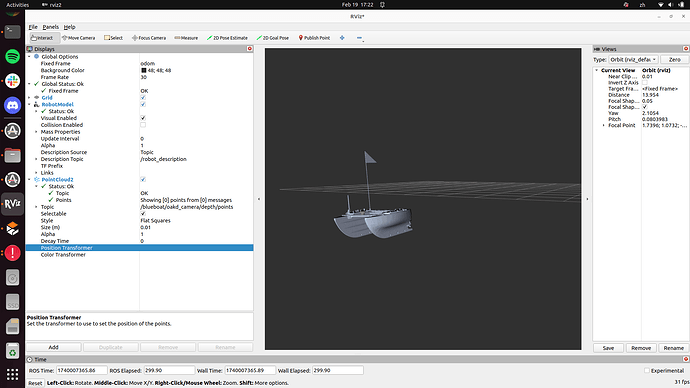

gz topic -lconfirms this), andros2 topic echoshows data being output. - In RViz, the
PointCloud2panel displays: “0 points from 0 messages” even though the topic is listed and data is echoed. - Gazebo also fails to display the point cloud visually.
SDF Configuration for the OAK-D Sensor:

Questions:
- What could be causing the point cloud not to display in Gazebo and RViz even though data appears to be published?
Any insights or suggestions would be greatly appreciated!
