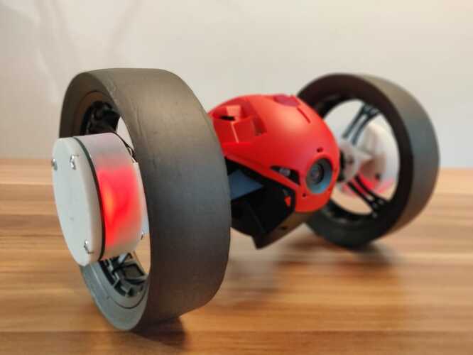

Once the problem is solved we will continue integrating the sensors in a comercial RC car (Parrot Jumping Sumo) and testing them with real data:
