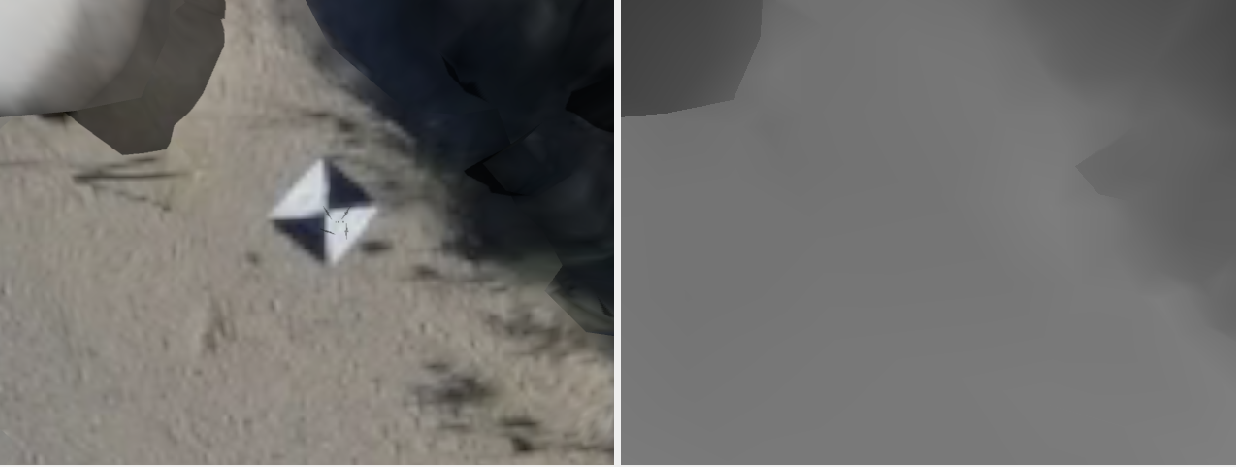

I noticed that using the parameters of focal length didn’t have any impact on the depth camera so I played around and found that manually setting the fov has an impact. I placed the calculated value but the images are still not aligned. (I also set the scale_to_hfov parameter to true for all of the cameras but still.
Here is an image of the result (left: left camera, right: depth camera gt at left position): (As can be seen the depth camera still seems a bit zoomed in compared to the reference image)
Thanks a lot for any ideas on this.
