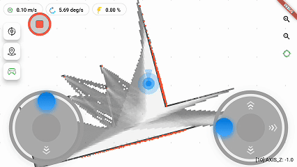

You can use flutter to develop apps. I have an open source version here.
https://gitee.com/ncnynl/ROS_Flutter_Gui_App
can you publish your research findings?
Hello and good day to you. I’m looking a GUI for Linorobot2, https://github.com/linorobot/linorobot2_hardware
Can ros_flutter_gui_app work with linorobot2 ?
Yes, You can use it .
Thank you. I see “Map Save :cross_mark:”. Is the latest version cannot save map?
Glad you got it working. Yes, there is no save map feature yet. We will also consider how to add this saved map later.
