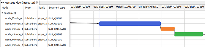

For example, I’d like to create the following diagram.
Visualizing Behavior

@hsgwa thanks for sharing your thought. this looks nice :+1:
I got a question about message flow.
Can we trace the specific message flow? for me, this looks more like statistics from each independent endpoint?
I was thinking about this kind of traceability before, i think for doing that we need to integrate unique identification in the message to trace. because we have no idea how many frames delayed in application or data process rate/frequency might be different from each application.
anyway, it would be really nice to trace the message flow :slightly_smiling_face:

Thanks for the comment!
I thought that latency statistics for each component are also needed to understand the overall performance, I included them as an example.
Measurements are tracked for each message and can be used for more detailed analysis.
Specifically, the following steps are used to track message flow.
Communication
In order to link publish to subscription, I use the information of source_timestamp that dds sends with the message as a unique message ID.
I thought using header.stamp, like the topic_statistics built into rclcpp, but I gave up because I was concerned it would restrict the message type and destroy the stamp value.
The source_timestamp is a value generated by the dds layer, so on the publisher side, we have to add a process to bind the message address to the source_timestamp.
The concern is I have also added the LDPRELOAD hook inside DDS, and the implementation depends on the DDS version as well :thinking:
Source code in the development stage used for the hooks in LD_PRELOAD can be found here.
https://github.com/tier4/CARET_trace/blob/main/src/hooked_trace_points.cpp

@hsgwa
thanks for the explanation, that helps me understand :+1:
(nit) precisely rmw implementation, not DDS.
So this is required and responsibility for rmw implementation, as far as i see all tier-1 implementation does that.
i think there ia a couple of concerns,
  • timestamp is not unique id. could be the same, also depends on accuracy.
  • what if system time is adjusted? i am not sure if only monotonic clock is used to fill in this field?

Messages entering and leaving the callback are different types
not only for types but also rate/frequency would be different. assuming subscription takes 3 messages and publisher publishes 1 message. in this case, we can still trace the message?

I’ve also been thinking about this ever since I worked on the message flow thing for ROS 1. Could you provide/link to an example where this happens? I think taking a specific use-case/example and applying some sort of heuristic based on knowledge of the implementation could work. Then for the trace data analysis part, the user (i.e., person running the analysis) has to provide information about the sub->pub type/behaviour for the data to be correctly interpreted. Another option is to provide an application-level tracepoint so that developers can provide this “link” themselves. Personally I’m always aiming for all of this instrumentation to be hidden from developers, but for these special use-cases it might be the best solution.

If we can produce a message flow, we can evaluate the performance of across multiple nodes.
For example, it would be nice to measure the time it takes for a message to enter the sensor node and be reflected in the actuator node.
However, I think it is important to note we can only track the message flow, not the actual movement of the actuator.
