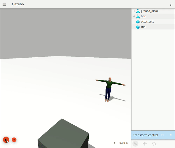

Actor simulation is now supported in Ignition Gazebo. The actor can be loaded from Collada files (.dae), and the actor animations can be specified by both Collada files (.dae) and BVH files (.bvh). We also add support to allow the Actor follow predefined trajectories.

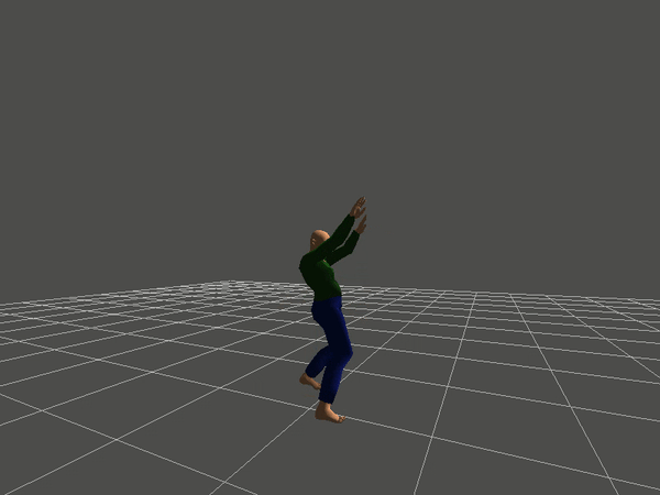

The testing process is to check how to render meshes according to the rendering engine. An example of rendering the actor mesh is implemented in ign-rendering, i.e., actor_animation. This example tests how an actor mesh can be loaded from the Collada file, and how the animations can be played both from Collada files and BVH files. The following functions were added to class ignition::common::Skeleton and ignition::rendering::Mesh to make this example work (see ign-common PR & ign-rendering PR for more details):
ignition::rendering::Mesh::HasSkeleton: whether the Mesh has a skeletal structure associated with itignition::rendering::Mesh::SkeletonLocalTransforms: get the local transformations of the mesh skeletonignition::rendering::Mesh::SetSkeletonLocalTransforms: set the local transformations of the mesh skeletonignition::common::Skeleton::AddBvhAnimation: Add an animation from BVH fileignition::common::NodeNameAnimToSkin: Finding the skin node name that corresponds to the given animation node nameignition::common::AlignTranslation: Get the transformation to align translation from the animation skeleton to skin skeletonignition::common::AlignRotation: Get the transformation to align rotation from the animation skeleton to skin skeleton
Note that the ignition::rendering functions only provide a high-level abstraction of APIs that need to be implemented based on the rendering engines. This project only implemented the rendering functions for Ogre engine, and the implementations for other engines, e.g., Ogre2, are left as future work. Furthermore, for the BVH animation to be correctly loaded to Collada animation, some additional frame alignments, i.e., translations and rotations, need to be made between the animation skeleton and Collada skeleton.
The following gifs show the rendering results (with Ogre engine).
- Skin and animation both from a single Collada file:
- Skin from a Collada file and animation from a BVH file
Note that this rendering of actor is a standalone example (not in Gazebo).
Load actor in Gazebo
The rendering of actor in Gazebo needs two more steps. The first step is to load the mesh and animations based on the input sdf, and the second step is to bridge the communication between the gz-client and the gz-server so that the actor can be visually presented at the client side.
- Step 1: Load the mesh and animations according to the sdf, see ign-gazebo PR:
ignition::gazebo::SdfEntityCreator::CreateEntities: Create all entities that exist in the sdf::Actor object and load their plugins.ignition::gazebo::SceneManager::CreateActor: Create an actorignition::gazebo::SceneManager::ActorMeshById: Get a rendering mesh given an idignition::gazebo::SceneManager::ActorMeshAnimationAt: Get the animation of actor mesh given an id
- Step 2: Communication between the gz-client and the gz-server, see ign-gazebo PR & ign-msgs PR:
ignition::msgs::Actor: new message proto, including Animation, Waypoint, Trajectory and Actorignition::gazebo::components::Actor: This component contains actor source information.ignition::gazebo::convert: conversion between an actor message and an actor
