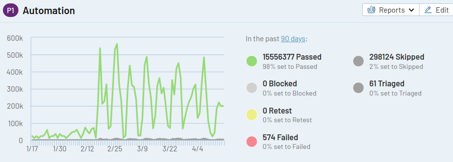

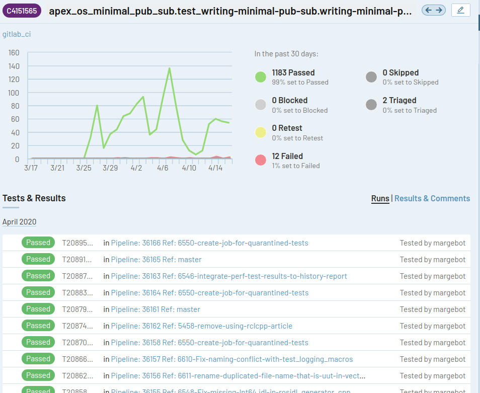

  2. Track broken tests - plotting the number of failures over time for each broken test helps you find new unstable tests and how often they are unstable

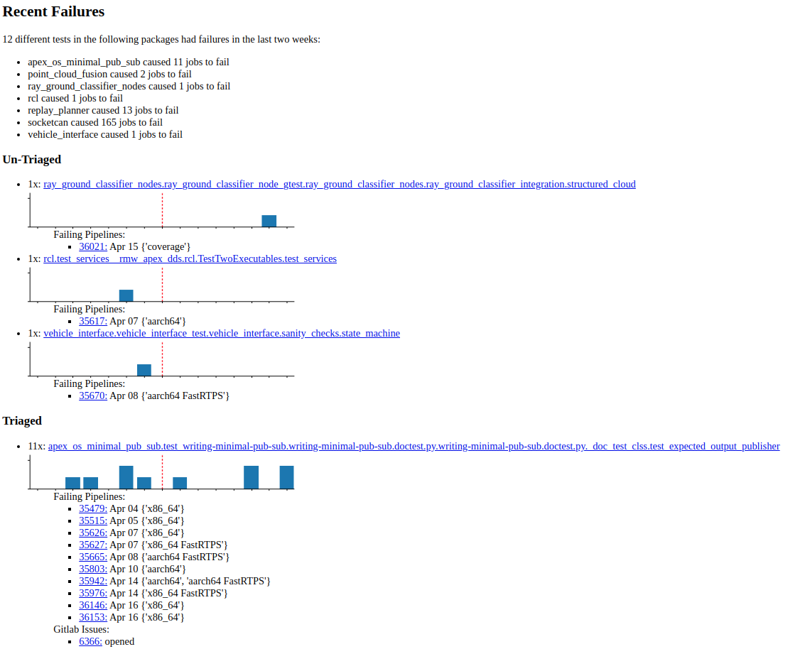

  4. Triage tests - a broken test shouldn’t prevent others from continuing to develop

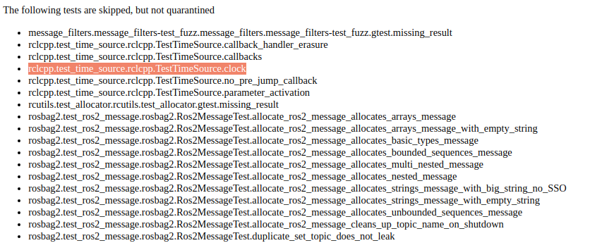

    • Skip the test and create an issue to re-enable and fix, we use GTEST_SKIP to skip the test and track the skipped tests in Test History Report
      SKIPTEST

This is excellent! Thank you for writing up the process. The big problem with flakiness is, of course, that it makes CI uninformative and unactionable. If the user expects green CI, then red CI or a newly failed test is an obvious issue. But if CI is always red or yellow, there’s not an obvious way to know when a change is concerning.
  1. How does Apex track when a failure is handled? Is there a way to make it visible from the CI status report whether a failure has an owner (e.g. a name, a link to a github issue, or an in-progress PR)? It’s often impossible to know even what repo to the failure is in let alone whether a failure has a known cause.
