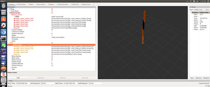

Additionally in Rviz (ROS1) it throws error with the RobotModel visualizatin .
Error In Rviz1:
[ WARN] [1513236342.717209109]: OGRE EXCEPTION(6:FileNotFoundException): Cannot locate resource package://rrbot_description/model/meshes/hokuyo.dae in resource group Autodetect or any other group. in ResourceGroupManager::openResource at /build/ogre-1.9-mqY1wq/ogre-1.9-1.9.0+dfsg1/OgreMain/src/OgreResourceGroupManager.cpp (line 756)
[ERROR] [1513236342.717426648]: Could not load model 'package://rrbot_description/model/meshes/hokuyo.dae' for link 'single_rrbot_hokuyo_link': OGRE EXCEPTION(6:FileNotFoundException): Cannot locate resource package://rrbot_description/model/meshes/hokuyo.dae in resource group Autodetect or any other group. in ResourceGroupManager::openResource at /build/ogre-1.9-mqY1wq/ogre-1.9-1.9.0+dfsg1/OgreMain/src/OgreResourceGroupManager.cpp (line 756)
RVIZ1
Any hints or solution would be appreciated.

I could reproduce this indeed. Though these meshes are not necessary to visualize the robot and by setting the Fixed Frame to “world” I could display the robot model with all the links and associated meshes.
At some point I had some missing transforms as well. It looks like only the /tf_static topic had data but I didnt receive anything on /tf (on the ROS2 side so nothing was bridged on the ROS 1 side). Killing and restarting the dummy_robot_bringup.py launch file fixed it.
In RViz2 it worked out of the box by simply running the dummy_robot_bringup launchfile in a terminal and RViz2 in a second terminal.
