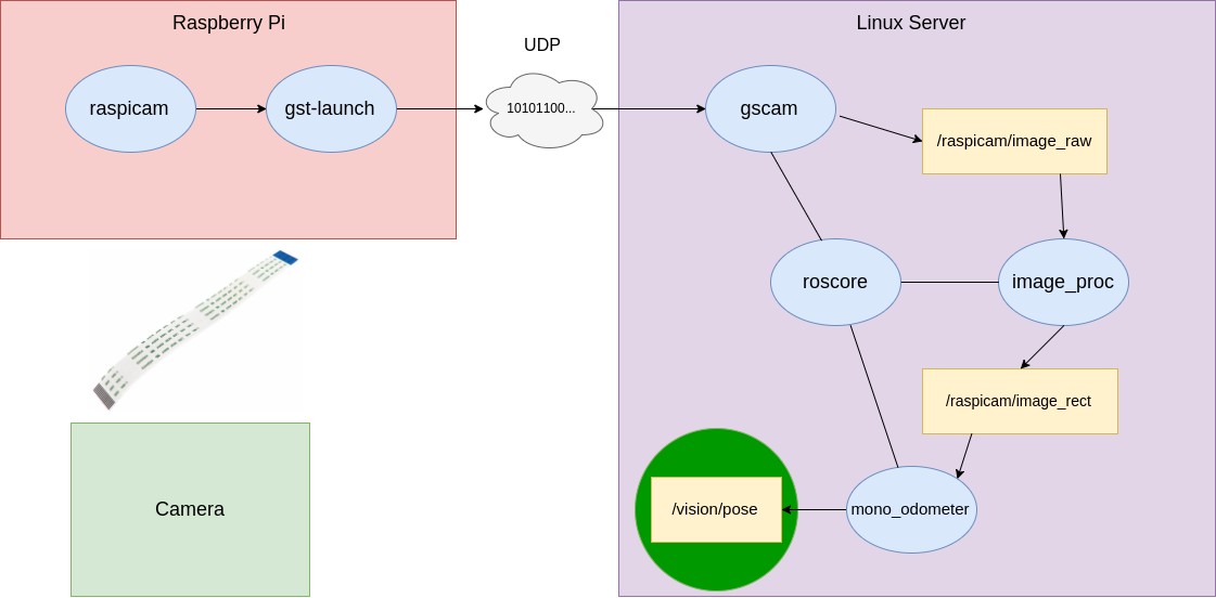

System architecture
If you absolutely have no idea what is ROS, nodes and how they communicate with each other, I strongly recommend you to learn it by reading official documentation and completing tutorials for beginners. Alternatively, you can read our guides. explaining its basic architecture and teaching how to write simple publisher and subscriber either on Python or C++.

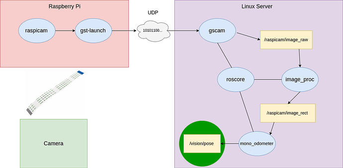

So, the graph of our system looks like this:
As you can see in this picture, we have Raspberry Camera connected and raspicam creating multimedia pipeline and sending video from camera to gst-launch. The latter then transmit the image to our server over UDP. gscam will broadcast the video to /raspicam/image_raw topic. This image should be rectified with image_proc node. And finally, rectified image is taken by mono_odometer, which handles it and computes position and orientation of the robot publishing this data straight to the /vision/pose topic.

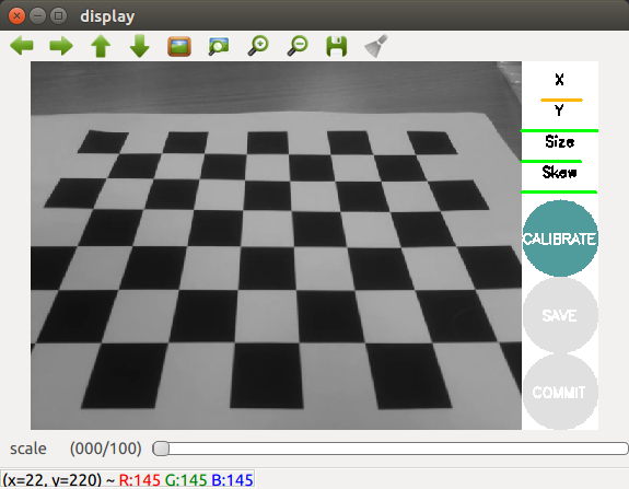

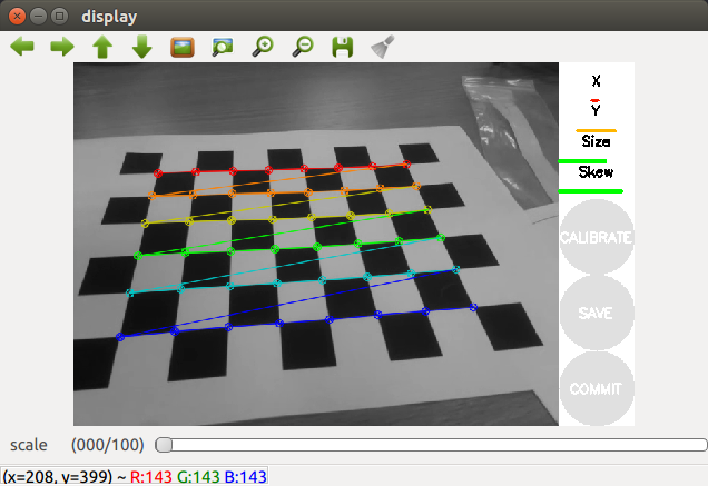

Calibrating the camera
Before Starting Make sure that you have a large checkerboard with known dimensions.
To calibrate camera we will use cameracalibrator.py node from package image_calibration which is already installed. To run it for a monocular camera using an 8x6 chessboard with 24mm squares just type:
rosrun camera_calibration cameracalibrator.py --size 8x6 --square 0.024 image:=/raspicam/image_raw
You will see a new window opened which will highlight the checkerboard:. This will open up the calibration window:
In order to get a good calibration you will need to move the checkerboard around in the camera frame such that:
  • checkerboard on the camera’s left, right, top and bottom of field of view
    • X bar - left/right in field of view
    • Y bar - top/bottom in field of view
    • Size bar - toward/away and tilt from the camera
  • checkerboard filling the whole field of view
  • checkerboard tilted to the left, right, top and bottom
As you move the checkerboard around you will see three bars on the calibration sidebar increase in length. When the CALIBRATE button lights, you have enough data for calibration and can click CALIBRATE to see the results.
Calibration can take about a minute. The windows might be greyed out but just wait, it is working.

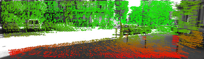

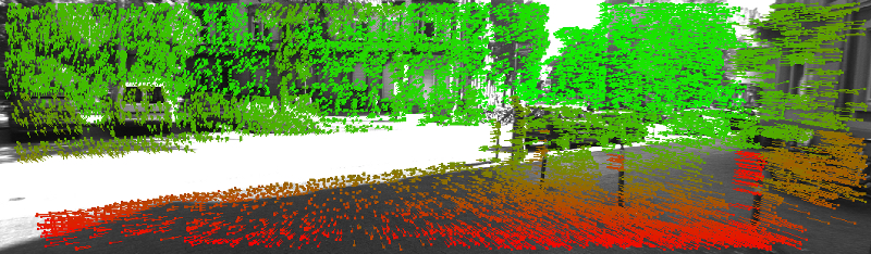

Getting odometry
$ rosrun viso2_ros mono_odometer image:=/raspicam/image_rect
This will publish /mono_odometer/pose messages and you can echo them:
$ rostopic echo /mono_odometer/pose

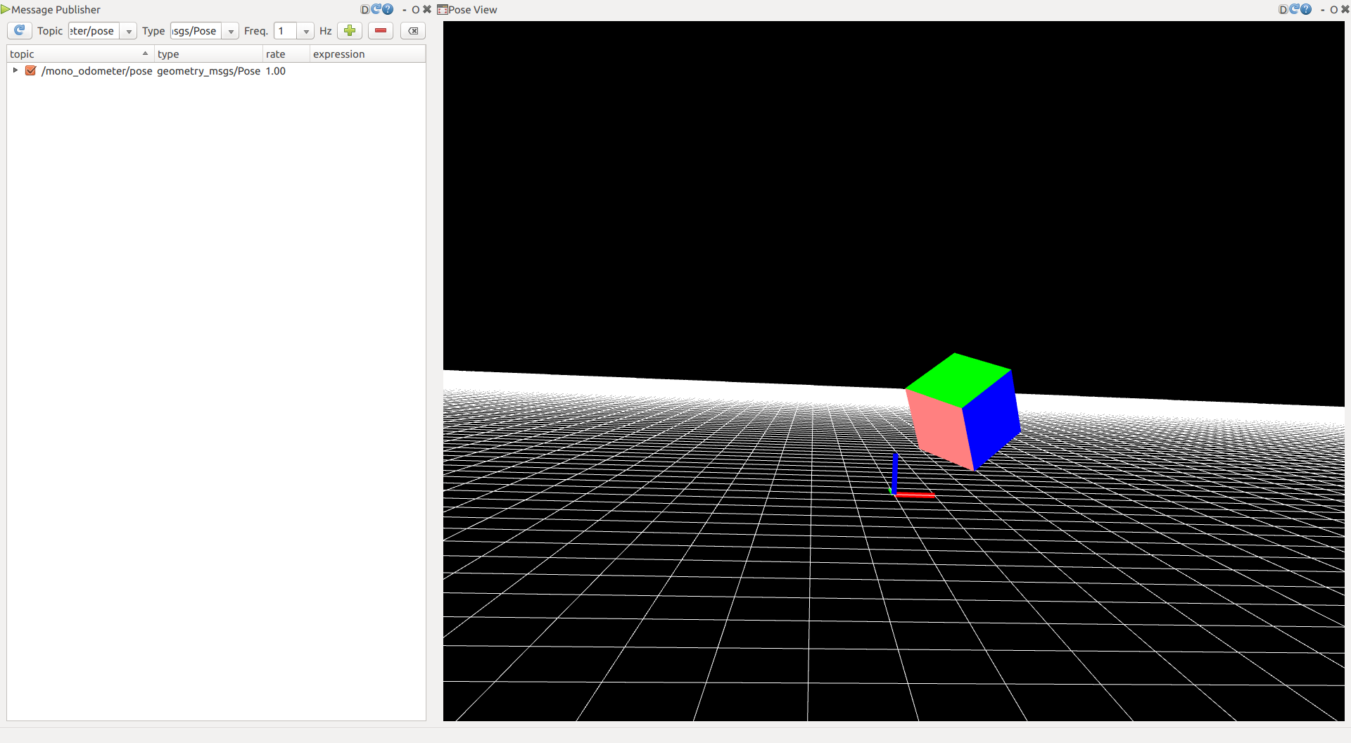

Visualizing pose
If you want to visualize that messages that is published into /mono_odometer/pose, then you should install and build another one package:
$ cd ~/odometry/src
$ git clone https://github.com/ros-visualization/rqt_pose_view.git
$ cd ~/odometry
$ catkin_make
The rqt_pose_view is a very simple plugin just displaying an OpenGL 3D view showing a colored cube. You can drag and drop a geometry_msgs/Pose topic onto it from the “Topic Introspection” or “Publisher” plugins to make it visualize the orientation specified in the message.
