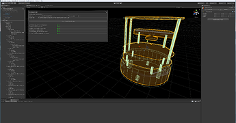

  • Visualize your Robot’s actual state and sensor Data in Unity3D (video) (see image below).
  • Simulate your robot in Unity3D with the data provided by the URDF and without using a connection to ROS (see video and post below).

My post above was limited to 5 links and 2 pictures only :frowning_face:
…here is some additional media :
(2)
(3)
