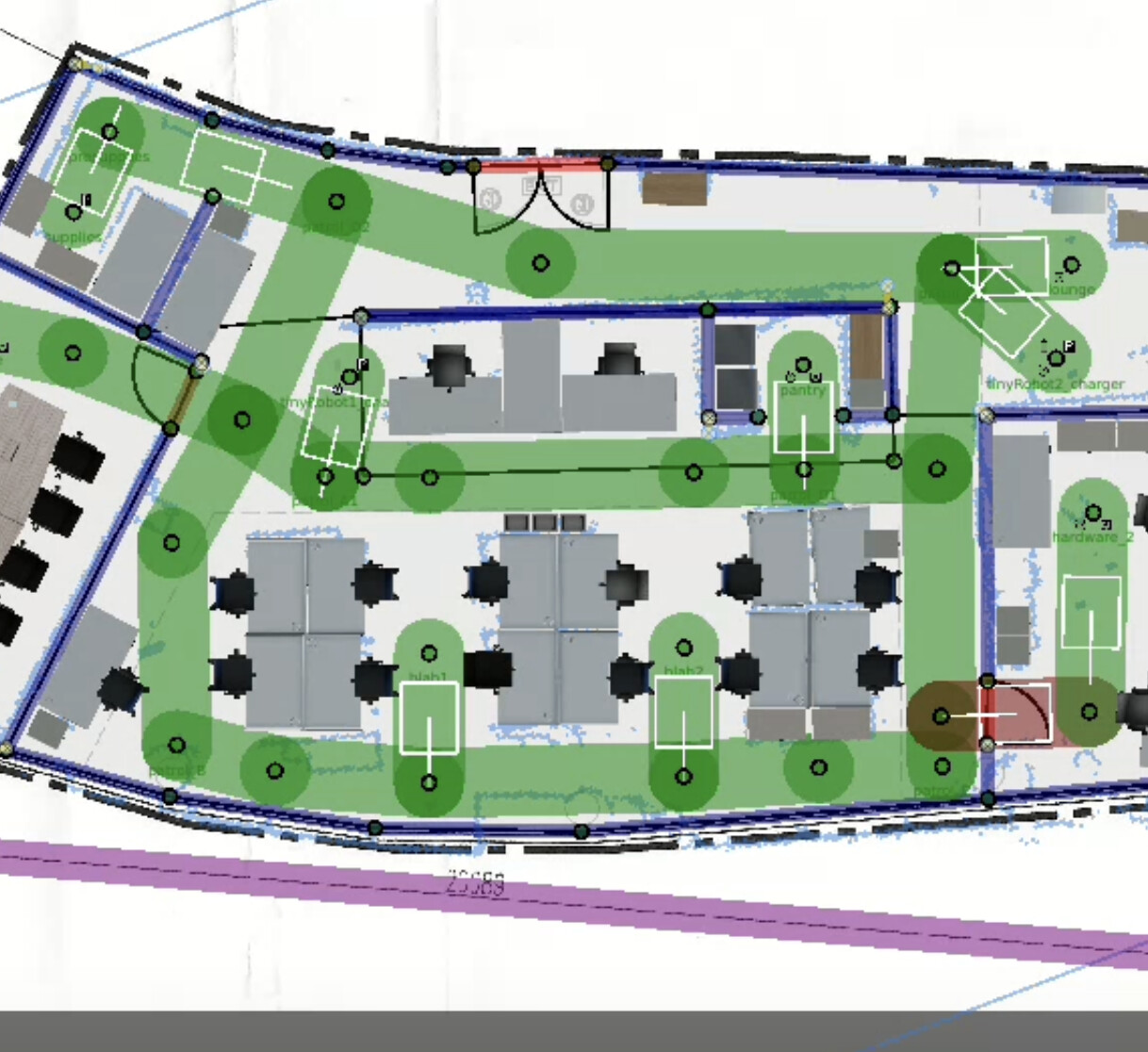

I’m trying to understand the behavior when orientation is set in the Traffic Editor.
My expectation is that when tinyRobot1 moves from blah2 to tinyRobot1_charger, it should move forward.
Similarly, I expected tinyRobot2 to move forward when traveling from tinyRobot2_charger to supplies.
However, instead of moving forward, the robot rotates in place and moves backward.
Is this behavior expected? If so, how can I configure it to meet my expectation?

Posted by @Yadunund:
It is expected behavior depending on how you’ve setup your traffic lanes and configure the capability of the robots in your fleet.
Looking at the video you shared it looks live you’ve added an orientation constraints to the lane extending out of blah2. If I were to guess it be that the constraint added is backward which causes the robot to rotate.
Feel free to repoen this ticket if the issue persists after removing orientation constraints on lanes.
