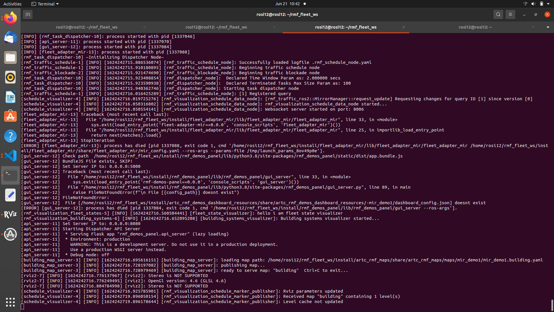

After running the schedule node and the fleet adapter mir, i launch the demo file to run visualization of the fleet and map on rviz.
In the photo below it states that the rmf_visualization_schedule_marker_publisher received the map, however it could not update the level cache.

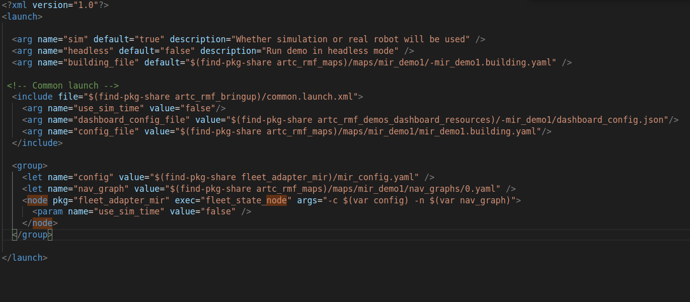

Below is a photo of my launch file:

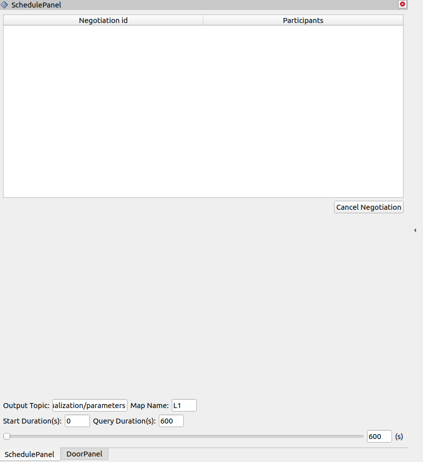

From a quick glance, it looks like you are not passing initial_map argument when you include the common.launch.xml file in your launch file above. Without passing this, the schedule visualizer will set a default value of “L1” as the initial map name. Hence, if none of the levels in your Building are named “L1”, the map markers will not be published to Rviz. So make sure that parameter is passed correctly. Alternatively, you can enter a valid map name in the “Map Name” box in the SchedulePanel in Rviz. You can save the Rviz config with the correct map name to avoid this in future runs.
