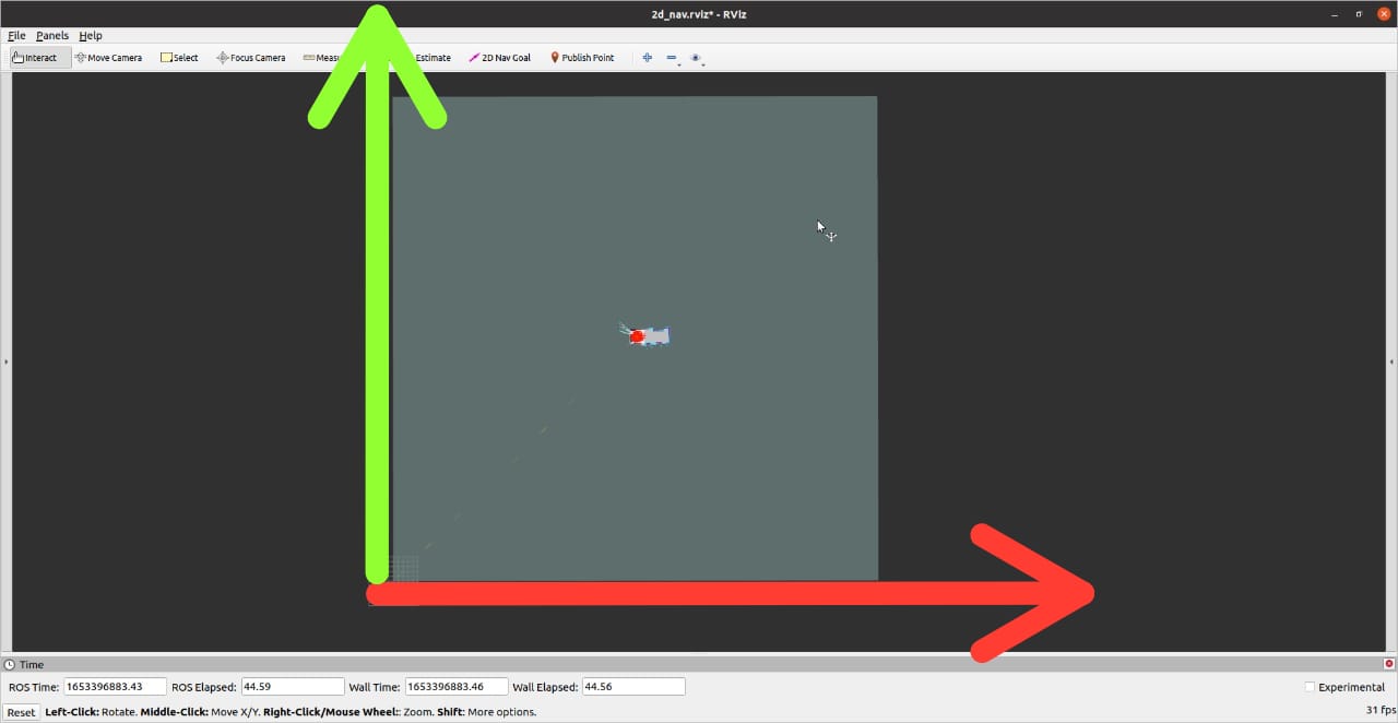

Hi, I have configured my ROS1 melodic robot with free_fleet and using ROS2 galactic on laptop as ros2 server and
RMF is build from source.

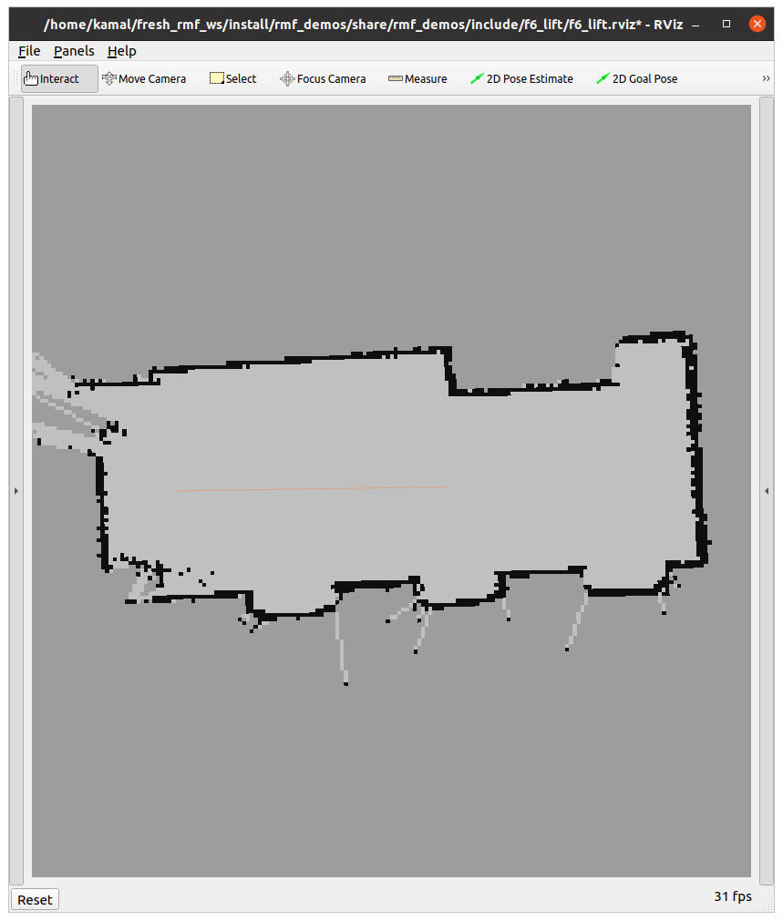

For creating building.yaml file i dont have the floor plan so i used the robot’s scan map for both Levels and Layers. hope that’s ok ![]()
The pink marker indicating robot position comes inside desired location only when transform parameters in free_fleet server launch file are set to start’s (x,y) with signs inverted (from above img).
COORDINATE TRANSFORMATION
translation x (meters): -45.778
translation y (meters): 44.955
rotation (radians): 0.000
scale: 1.000
I also tried the transforms values in right side of layers tab but the pink marker was out of bound.
I think this error might be due to cordinate transform mismatch between RMF and robots coordinate. although i’m not sure how to go about fixing it. i hope you can help me.
