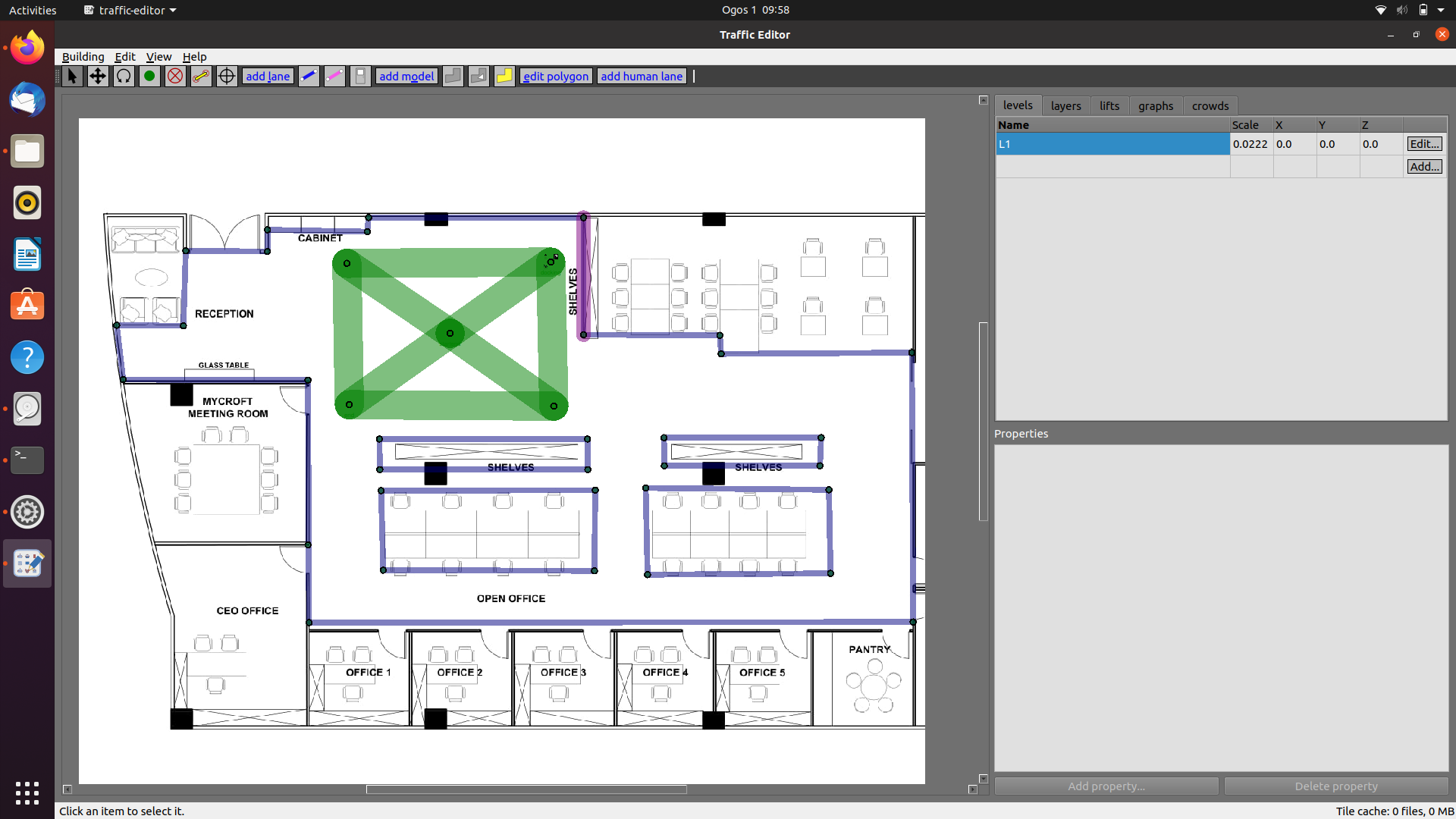

Whenever I start the robot while it not directly being on any waypoint, it starts moving towards the nearest waypoint (and it physically moves towards it as well) but upon reaching the waypoint there’s the same error and it is unable to find a greedy solution so it dies.
Here is a screenshot of the traffic editor file I am using:

I have confirmed that the fleet states are constantly being sent correctly, even after the fleet adapter dies and everything on the free fleet side is working as intended.
Any help on this matter would be greatly appreciated, Thanks in advance!

Answered by @Yadunund:
Hi there,
Which waypoint does the robot start at/move towards? Can you confirm that this waypoint is actually connected to the navigation graph? For example, if it starts at the intersection of the diagonals, can you check whether that wayoint is actually connected to the navigation graph? ie, it is not a dangling waypoint that is underneath a lane.
Is your Robot <=> RMF transformation accurate? You will need to update the transformation values in the free fleet server config file. For a sanity check, if you compare the coordinate of the robot reported in its FleetState msg with the actual RMF coordinate of that location (can be inferred from Traffic Editor), what is the error?
