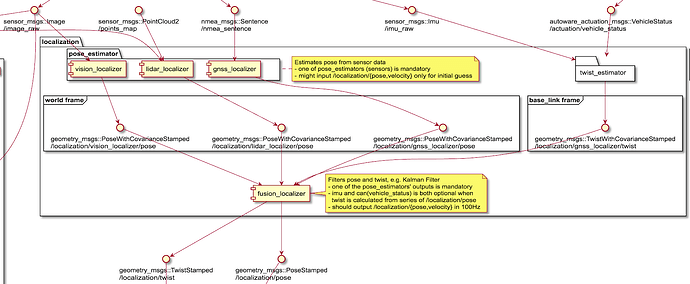

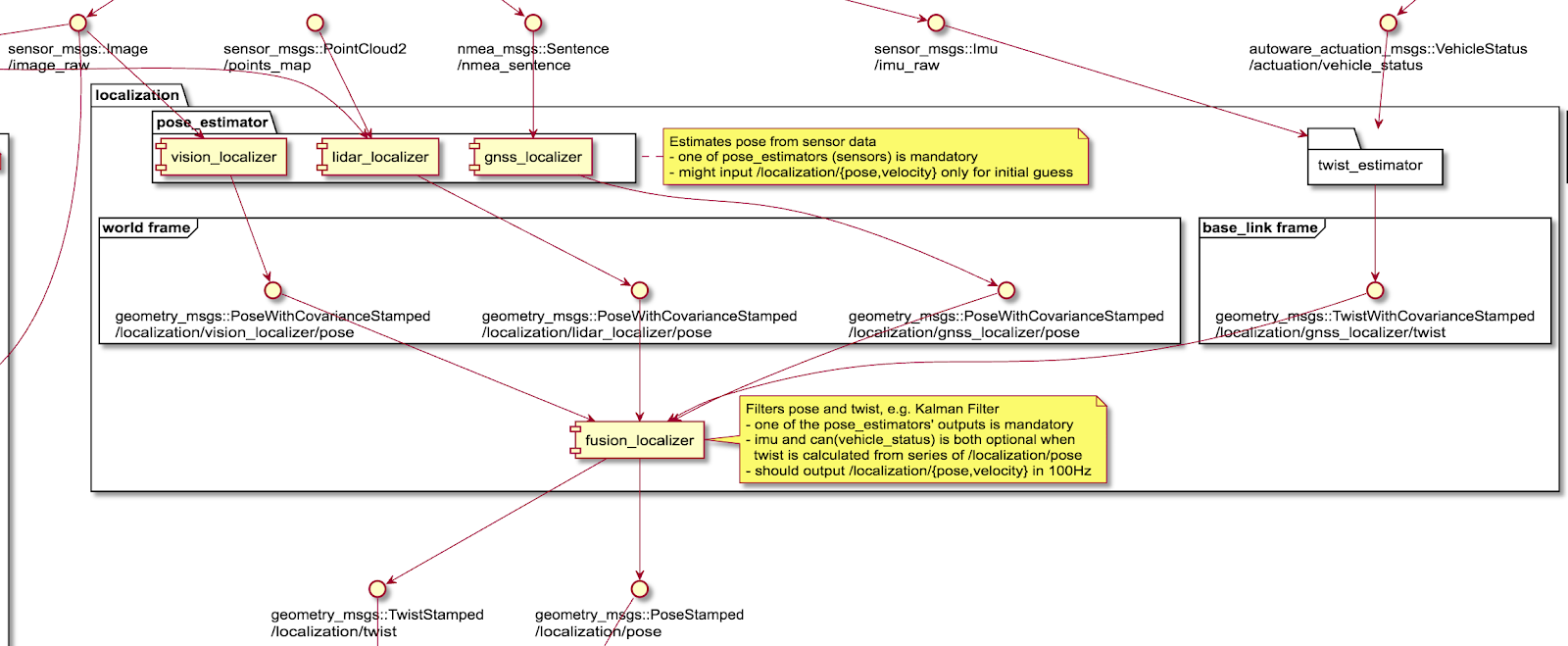

Abstract
The new architecture accepts multiple configurations of sensors and localization algorithms by using sensor fusion such as EKF (Extended Kalman Filter) and PF (Particle Filter).
The minimum configuration is the same as the current Autoware. Localization shall work only with LiDAR. The other sensors and vehicle data are optional.
Descriptions
This proposal is a starting point of the discussion. Feel free to comment :slight_smile:
localisation data flow v20190403_1.pdf (12.7 KB)
In the interests of keeping the information in one place and easy to access, here is the content of that Google Docs file.
Background
The current Autoware (v1.11) depends only on LiDAR (ndt_matching). Other inputs such as GNSS, CAN, and IMU are used to guess initial search position in ndt_matching algorithm. It is difficult to scale up scenarios which Autoware can drive.
This discussion was made at Localization Architecture · Issue #461 · autowarefoundation/autoware_ai · GitHub and moved to Discourse Localization Architecture - Autoware - Open Robotics Discourse.
Abstract
Descriptions
This figure is in progress and will be updated based on discussions.

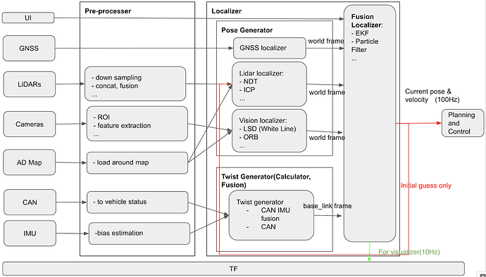

Inputs of Localization
  • Localization inputs sensor data. The sensor data might be pre-processed before localization. The detail has not defined in the figure yet. For example, concatenating pointcloud might be outside of localization.
  • Imu and can(vehicle_status) is both optional when twist is calculated from series of /localization/pose.
  • One of pose_estimators (sensors) is mandatory. The others are optional. The accuracy of localization depends on which sensors and algorithms are selected.
Outputs of Localization
  • Localization outputs pose and twist. Localization should output them in at least 100Hz for accurate control. The output can be in 100Hz by e.g. linear interpolation even if sensors output data less than 100Hz.
Inputs of Fusion
  • Pose
    • Shall input one of the pose_estimators’ outputs.
    • Shall be aligned to world frame.
    • Has covariance for fusion.
  • Twist
    • Shall be aligned to base_link frame.
    • Imu and can(vehicle_status) is both optional when twist is calculated from series of poses.
I’ve added two modifications for clarification.
# Abstract
- The minimum configuration is the same as the current Autoware. Localization shall work only with LiDAR. The other sensors and vehicle data are optional.
+ The minimum configuration is the same as the current Autoware. Localization shall work only with one sensor, e.g. LiDAR. The other sensors and vehicle data are optional.
Inputs of Fusion
  * Pose
    - Shall input one of the pose_estimators’ outputs.
    - Shall be aligned to world frame.
    - Has covariance for fusion.
  * Twist
    - Shall be aligned to base_link frame.
    - Imu and can(vehicle_status) are both optional when twist is calculated from series of poses.
+   - Has covariance for fusion.
