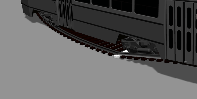

What kind of train we are talking about? With fixed or rotating bogies? For example here rotating bogies.

I see in your picture that you successfully made the bogie rotate around its z- and y-axis, lovely!
Actually I will need both later: a wagon with two bogies (each bogie has two wheelsets) that rotate around their z-axis and a wagon with two wheelsets which in my opinion could be simplified as one rotating bogie.
There will be one vehicle/locomotive with two wheelsets. This loco pulls freight wagons. A freight wagon may have either two wheelsets or two bogies.
But for now - if I may suggest - I would like to start with just with one vehicle with two wheelsets (see picture) which is the same as one vehicle with one fixed bogie.
