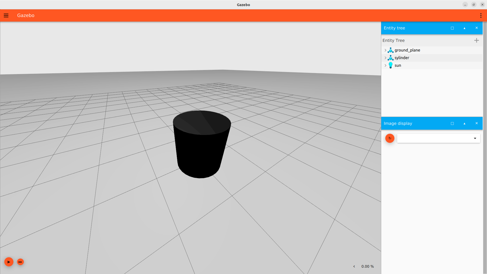

Is there a way to give initial velocity or force to the model in the gazebo?
Operating environment
ROS 2 Humble
Ignition Gazebo (Fortress)
SDF version 1.8
I wanna move the cylinder without power on the Ignition Gazebo.
e.g. How to give speed information to objects without wheels or links, etc.
Thank you for your cooperation.

By now, I found the way to give force to the model in ignition gazebo.
I’ll share it, how to method.
add plugin in sdf.
    <plugin
      filename="gz-sim-apply-link-wrench-system"
      name="gz::sim::systems::ApplyLinkWrench">
      <persistent>
        <entity_name>cylindar</entity_name>
        <entity_type>model</entity_type>
        <force>-10 0 0</force>
        <torque>0 0 0.1</torque>
      </persistent>
    </plugin>
or, add plugin in sdf
    <plugin
      <persistent>
      </persistent>
    </plugin>
finally, input in following command incommand line.
ign topic -t “/world/world_name/wrench” -m ignition.msgs.EntityWrench -p "entity: {name: ‘model_name’, type: MODEL}, wrench: {force: {x: 20000, y:100}}”
