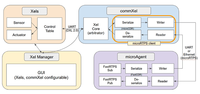

Introducing the XEL Network : Modular H/W ecosystem over ROS2
Hi!
I have brought new project news related to ROS2.
The name of this project is XEL Network
“XEL” is a word derived from the robot actuator “DYNAMIXEL” and uses the characteristics of DYNAMIXEL communication.
The main concept of this project is to standardize it so that robot hardware can be configured more easily using the features of DDS used in ROS2.
The GOALS of this project are as follows.
  • Generalization of Software Mechanism in Robot Development with Embedded Technology.
  • Complete open source hardware.
  • Simpler and easier robot development through the above goals.
The main FEATURES of this are as follows.
  • Support ROS2(DDS using microRTPS)
  • Plug And Play
  • Daisy chain connection
And our ROADMAP is as follows.
  • Support ROS2 (Publisher and subscriber are implemented)
  • Plug And Play (Implemented using the DYNAMIXEL protocol. Additional supplement needed.)
  • More sophisticated real-time performance.
  • Supports various message types.
  • Support GUI program (XEL Manager)
  • Support IDE likes Arduino for user customizing.
  • Support multi topics on one device. (Currently, only one topic per one is possible.)
What has been developed so far is only a simple function, and it requires a lot of function addition, stabilization and optimization.
But, as one of our goals is a complete open source hardware, we would like to develop it with anyone interested in this project. So I post this here that this project is there and it has progressed to this extent.
Here are the GitHub repositories that are currently open.
For more information on this project, please refer to the following wiki document.
We specially thanks to ROS2 developers and ROS community and eProsima developers.

How dependent is this on the dynamixel protocol? Of course the hardware is, but do the message also contain specifics? btw, which messages are you using?
Apropos, @vmayoral already mentioned HRIM, which is their proposal on meta-data describing hardware (at least that’s how I understood it :slight_smile:). I’ve also seen other work which uses a big YAML file with meta-data. Interoperability and pluggability would greatly benefit if the community could agree on this. How about a meeting on this at the ROSCon?
Hi, @iluetkeb.
We chose TTL, RS485 communication to use relatively inexpensive hardware. And since DYNAMIXEL, one of the actuators, uses serial interface and protocol is open, we applied it.
But finally, we plan to make other communications available through the abstraction layer.
We are planning Modbus as the second protocol to be implemented.
The current messages only support some standard messages, and there is a need to worry about adding and customizing messages.
It is still in its infancy, so there is room for improvement. :slight_smile:
In addition, we are using ROS2 in TB3. The ROS2 related code (including microRTPS) used in TB3 is the same as XEL Network.
