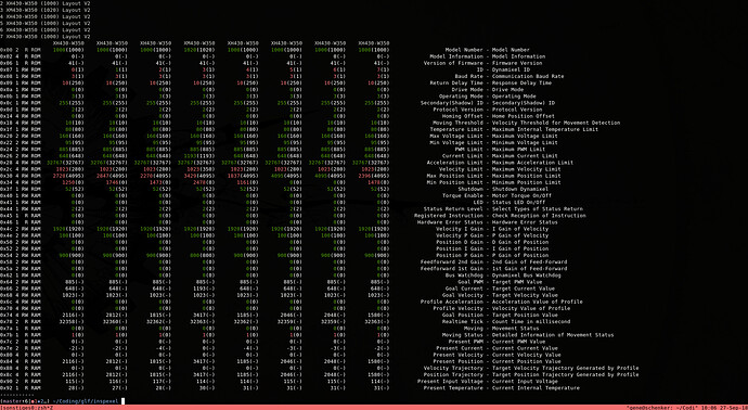

Detect motors
A single command will detect motors on the bus reads all their registers: inspexel detect --read_all.
It gives a nice overview over their state and how they deviate from the default value.
