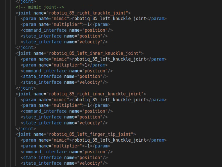

Hello,I am a student from Taiwan.
I have same question with mimic joint of robotiq_85.
how do i apply the ros2_control of mimic joint to gazebo harmonic?
do any lib or sucess build of mimic joint made by sdformat?
or how can i use mimic joint in gazebo harmonic in sdformat?
version
ubuntu 22.04
gazebo harmonic
ros2 humble
model
robotiq_85
ur5
in harmonic, mimic joint has been implemented.
you can see a file mimic*.sdf in /usr/share/gz/gz-sim8/worlds/ directory.
you read the sdf file and you can run and test, then use it in you project.
