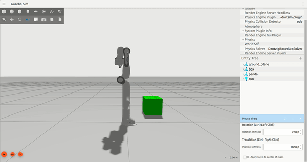

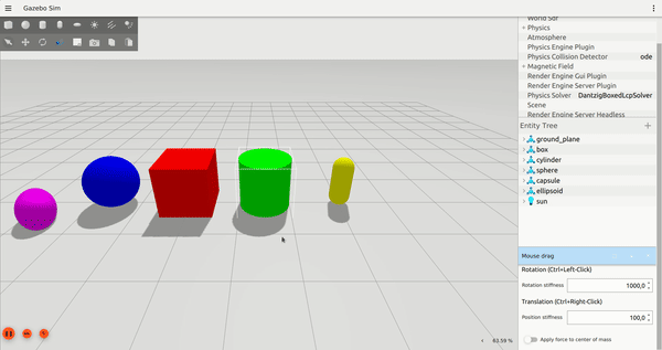

Mouse Drag plugin
The Mouse Drag plugin allows the user to drag objects around in the scene with the mouse cursor by applying forces and/or torques to links during the simulation. This will enable use cases such as easily moving objects in the scene, emulating human-robot interaction, and perturbing control systems. This plugin provides two dragging modes: translation and rotation.
The translation mode, activated by Ctrl+Right-clicking and dragging a link in the scene, allows the user to pull the object towards the mouse position. Through an option in the interface, it can be specified if it should be pulled from the link’s center of mass or from the point of the initial click on the link.
The rotation mode, activated by Ctrl+Left-clicking and dragging a link in the scene, allows the user to pull the object towards a desired orientation, only applying a torque to it.
