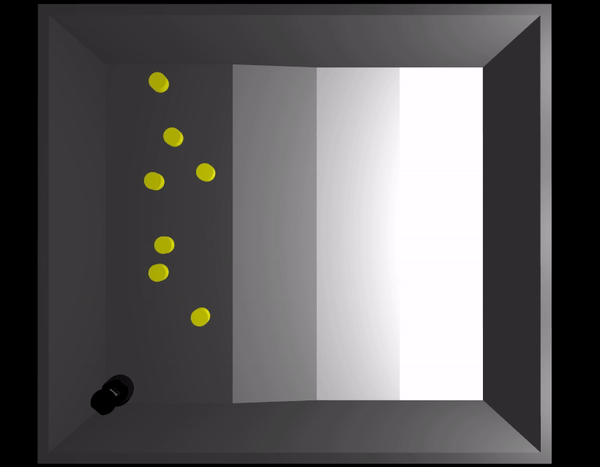

I’m runnning a neuroevolution algorithm using Gazebo Fortress and ROS 2 Humble, with the Turtlebot 4 robot. In my project I need to run ~10k short runs (1 minute each) and for every run I need to change the starting position of the robot and the objects (yellow cylinders), as shown in the video below.
To do this I have a bash file that calls the gazebo service to set the new position of the objects, the command is the following:
ign service -s /world/arena/set_pose --reqtype ignition.msgs.Pose --reptype ignition.msgs.Boolean --req \"name: 'object$obj_id' position: { x: $(eval echo \$OBJECT${obj_id}_X), y: $(eval echo \$OBJECT${obj_id}_Y), z: $OBJECT_Z} orientation: { x: 0.0, y: 0.0, z: 0.0, w: 1.0 }\" --timeout 5000

To change the position of the turtlebot4 I use the following command: ign service -s /world/arena/set_pose --reqtype ignition.msgs.Pose --reptype ignition.msgs.Boolean --req \"name: 'turtlebot4' position: { x: $TURTLEBOT_X, y: $TURTLEBOT_Y, z: $TURTLEBOT_Z } orientation: { x: $TURTLEBOT_QX, y: $TURTLEBOT_QY, z: $TURTLEBOT_QZ, w: $TURTLEBOT_QW}\" --timeout 2000.
What I have noticed is that after some runs I need to repeat these commands multiple times to move the robot and the objects since I keep receiving the output Service call timed out.
