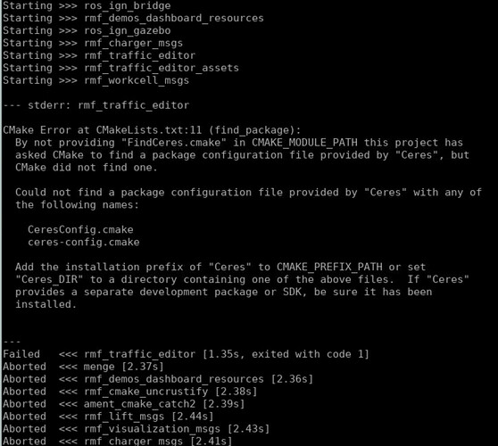

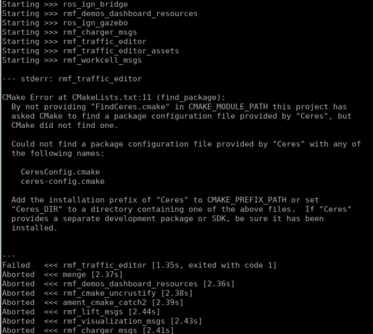

I tried to build: colcon build --cmake-args -DCMAKE_BUILD_TYPE=Release but i get an error with the CMakeLists.txt file. I don’t know why, have somebody an idea?

From first glance it looks like the libceres-dev library is missing which is a dependency of rmf_traffic_editor. But this should get installed automatically when you run rosdep install --from-paths src --ignore-src --rosdistro foxy -yr as stated in the README instructions.
