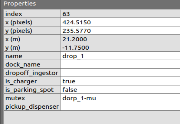

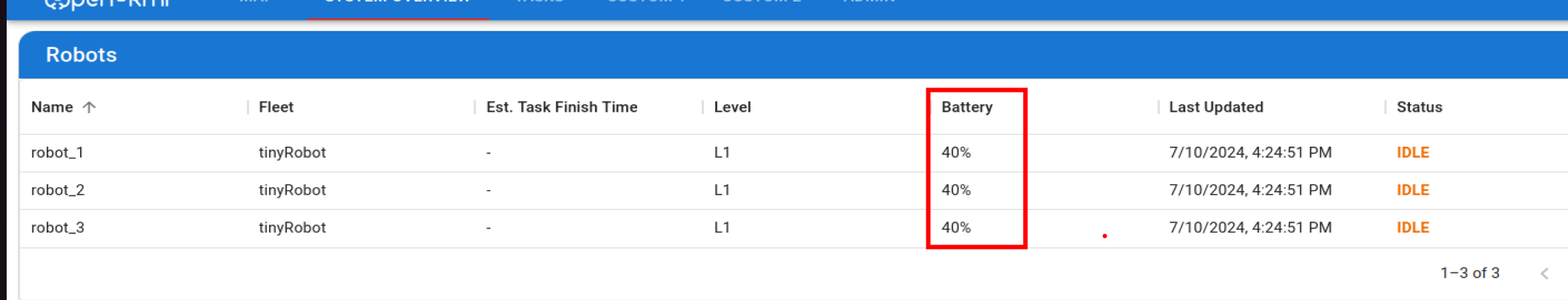

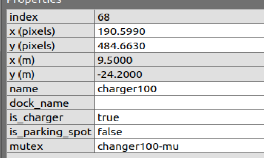

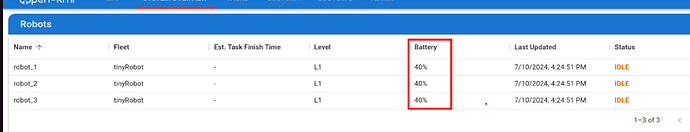

The image above shows my robot’s battery level, which I have set to 40%, and the waypoint information.
I noticed that when the battery level is sufficient, after completing a task, the robot returns to the point configured as the charger in the YAML file, even though this point is not set as a parking spot. What could be causing this? I look forward to your response.
Posted by @xiyuoh:
I’ve tried out your config with rmf_demos Office world, and I found that the robot will still go to the charger if the recharge_soc is set to 1.0. Meaning that whenever the robot is detected to fall below the recharge_soc, it will head to the charger. You could try tweaking this value and bringing it down to an acceptable SOC.
