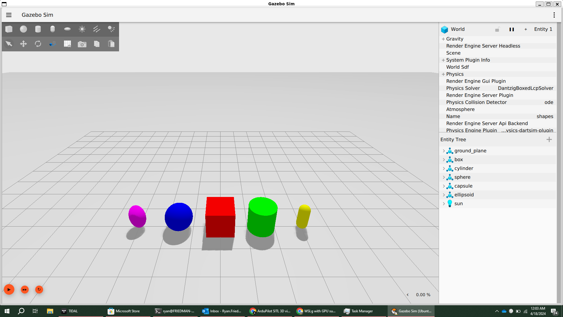

Neat. It’s much faster (responsive) than Gazebo in VMWare. I tested harmonic on Windows 10, with a 12th Gen Intel(R) Core(TM) i7-12850HX CPU and Nvidia RTX A3000 GPU. The shapes.sdf file loads fine.
