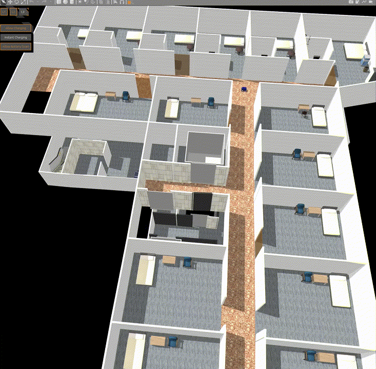

The multi-level hospital in this Open-RMF demonstration is simulated with Gazebo.
